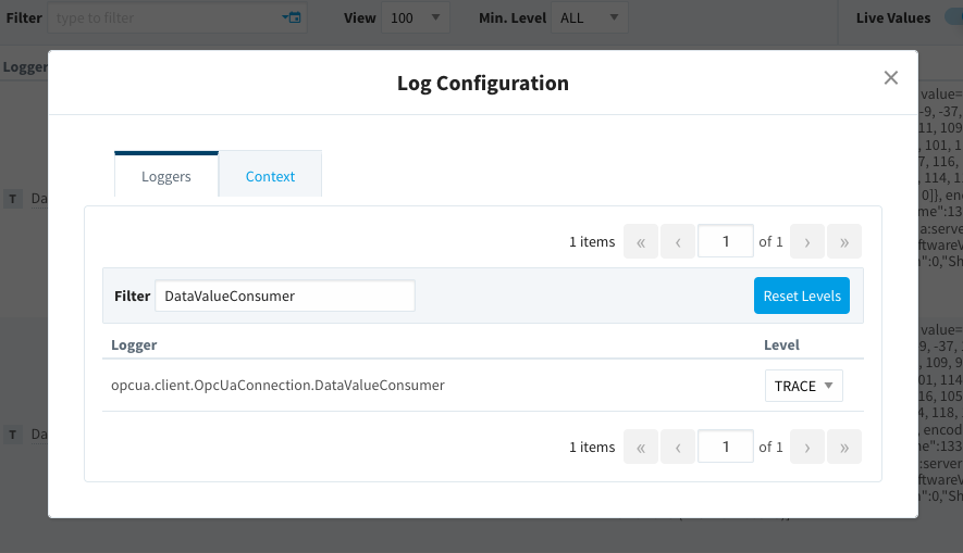

**Post date:** [July 17, 2025, 3:45pm UTC](https://forum.inductiveautomation.com/t/help-me-with-opc/108605/13 "2025-07-17T15:45:41Z")
Well, you could turn on the logger for `DataValueConsumer` to TRACE level and probably see the initial null/Bad\_NotConnected come in, and then watch, uh... the absence of values arriving. But it's a little less compelling than something objective like a Wireshark capture when you have to go report a bug.
 ![image](https://us1.discourse-cdn.com/inductiveautomation/original/3X/0/e/0e78785ad72536af9670592ad6dc2f22321f3b81.png)
