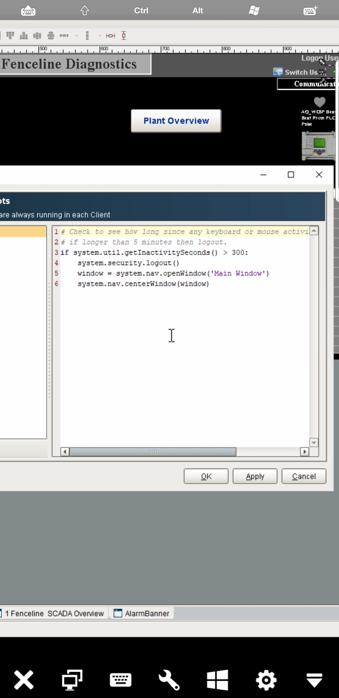

I tried it and it still completely logged off. Here is the script.
`Preformatted text<img src="//cdck-file-uploads-us1.s3.dualstack.us-west-2.amazonaws.com/inductiveautomation/original/2X/3/34160decafb6f7f9ca5791433fa6edf9e651a64c.jpg" width="243" height="500">`
 ![](https://us1.discourse-cdn.com/inductiveautomation/original/2X/3/34160decafb6f7f9ca5791433fa6edf9e651a64c.jpg)
**Author:** ![witman](https://avatars.discourse-cdn.com/v4/letter/w/d2c977/32.png) [@witman](https://forum.inductiveautomation.com/u/witman)\
**Post date:** [December 11, 2018, 6:15am UTC](https://forum.inductiveautomation.com/t/help-on-log-out-navigation/21326/7 "2018-12-11T06:15:03Z")
Yes, you can add to/edit the scripts it creates. However, if you log out and don’t have auto login enabled you’ll just get the login screen, not the Main Window page you’re looking for.
In Designer, go to Project-\>Properties-\>Client Login to setup auto login for a user with access to only what you want accessed before login (at least the Main Window). You’ll need to check Enable Auto-Login and fill in that username and password you want it to switch to on logout to allow access to Main Window.
Then your script will likely work. You may need to put the window change lines before the logout line in the script.

Your script in screen clipping above will run any time there is no activity (mouse movement, etc.) for ten seconds when the script runs. If you want it to wait for a longer period of inactivity, change the “10” in it to the number of seconds of inactivity you want to require to execute the lines indented below the if.

Based on your use of `system.util.getInactivitySeconds()` I assumed this script was running somewhere other than on a logout button. If this is on your logout button, your script while never run because the inactivity seconds will always be zero when it runs (due to the fact the button was just pressed, which counts as activity). If this is on a button, you probably want your script to run any time the button is pressed. Remove the if condition like this:
```auto
window = system.nav.openWindow('Main Window')
system.nav.centerWindow(window)
system.security.switchUser('view', 'view')
