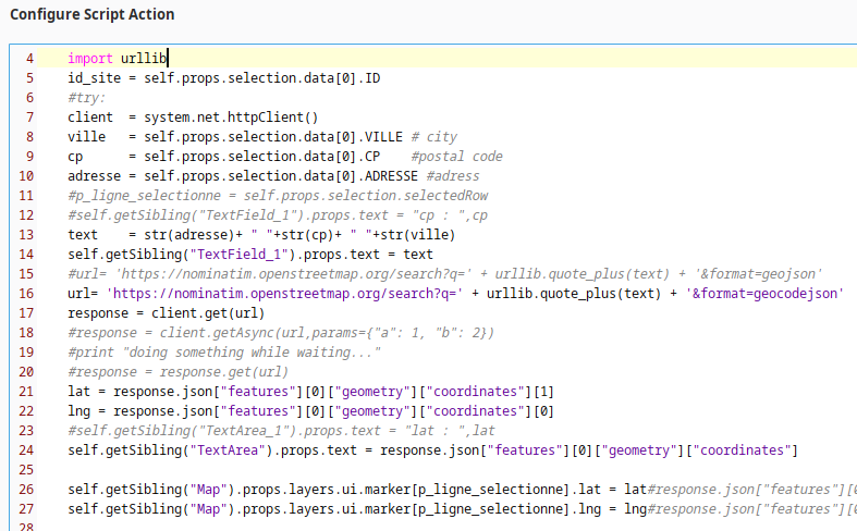

Hello, I have a problem with the GET method. it work on the local but when I put my projet on the server it does’nt work.
I’m working on a project, I need to display an address on the map. To do this, I use the city name, zip code, and address.
I’m trying to retrieve latitude and logitude using an API
When I run the code on the local, the GET method works, I manage to retrieve the latitude and longitude then the markers are displayed on the map.

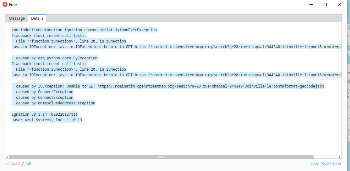

But when I run the code on the Server it gives me the error below.
 ![image](https://us1.discourse-cdn.com/inductiveautomation/original/3X/b/7/b75a6bc54f8ac72584d786a61052738f8316b497.png)
my script
 ![image](https://us1.discourse-cdn.com/inductiveautomation/original/3X/4/f/4fd519cf76ec3f774822ec8874cfe9916ea917b6.png)
com.inductiveautomation.ignition.common.script.JythonExecException
Traceback (most recent call last):
File “function:runAction”, line 20, in runAction
java.io.IOException: java.io.IOException: Unable to GET [https://nominatim.openstreetmap.org/search?q=Rue+du+8+Mai+1945+75010+Paris&format=geocodejson](https://nominatim.openstreetmap.org/search?q=Rue+du+8+Mai+1945+75010+Paris&format=geocodejson)
caused by org.python.core.PyException
caused by IOException: Unable to GET https://nominatim.openstreetmap.org/search?q=Rue+du+8+Mai+1945+75010+Paris&format=geocodejson
caused by ConnectException
caused by UnresolvedAddressException
Ignition v8.1.14 (b2022012711)
Java: Azul Systems, Inc. 11.0.13
**Author:** ![victordcq](https://avatars.discourse-cdn.com/v4/letter/v/f6c823/32.png) [@victordcq](https://forum.inductiveautomation.com/u/victordcq)\
**Post date:** [April 15, 2022, 8:19am UTC](https://forum.inductiveautomation.com/t/help-plesase-get-http-methode-dont-work-on-the-server/58498/2 "2022-04-15T08:19:04Z")
I hope that address doesnt point to your house xd
The error and your code does not seem to match. Line 20 is commented out
Im guessing it might be because its https while your server is running in http. no idea tho,
Im not having problems getting a response from it on my local machine

probably a firewall or security config thing then or something
**Post date:** [April 15, 2022, 12:03pm UTC](https://forum.inductiveautomation.com/t/help-plesase-get-http-methode-dont-work-on-the-server/58498/5 "2022-04-15T12:03:36Z")
Unresolved address is a DNS error. Something is squirrely in the server’s DNS setup.
**Author:** ![peter](https://avatars.discourse-cdn.com/v4/letter/p/278dde/32.png) [@peter](https://forum.inductiveautomation.com/u/peter)\
**Post date:** [April 15, 2022, 1:55pm UTC](https://forum.inductiveautomation.com/t/help-plesase-get-http-methode-dont-work-on-the-server/58498/6 "2022-04-15T13:55:29Z")
As previously mentioned, it is likely that there is a network configuration difference between your server and your dev box. You can potentially eliminate Ignition from the equation if you open a command/terminal window on your server and attempt to ping the map API. EG
`ping nominatim.openstreetmap.org`
This worked for me from my local dev box and returned:
```auto
PING corvallis.nominatim.openstreetmap.org (140.211.167.100): 56 data bytes
64 bytes from 140.211.167.100: icmp_seq=0 ttl=45 time=54.091 ms
64 bytes from 140.211.167.100: icmp_seq=1 ttl=45 time=51.430 ms
64 bytes from 140.211.167.100: icmp_seq=2 ttl=45 time=51.581 ms
If this doesn’t work from your server, then it’s likely to be a firewall/network configuration error either on the server, or perhaps in the networking equipment (switch etc) that the server connects to.
