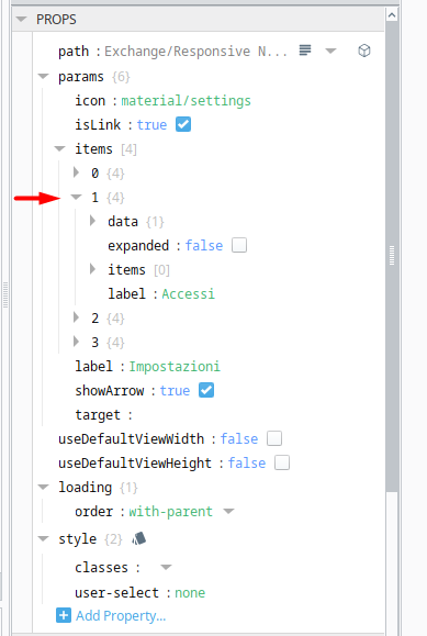

Hi,
We have a menu and one item have sub items. How can I hide a single item depending on a condition?
 ![image](https://us1.discourse-cdn.com/inductiveautomation/original/3X/e/a/ea5159505180ec2b0aa2e4e3d7623c58cbc4a3a9.png)
**Post date:** [September 12, 2025, 11:16am UTC](https://forum.inductiveautomation.com/t/hide-sub-menu-item/110569/2 "2025-09-12T11:16:41Z")
I would dynamically construct the entire `props.items` tree, omitting what doesn't apply.
