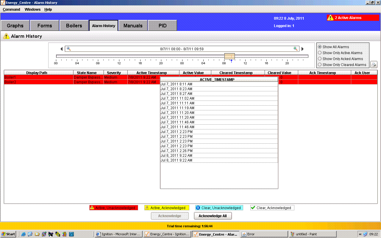

I have copied the Alarm History page from the IADairy example project and altered it to work on my Alert Storage table. My problem is that I cannot get the Histogram feature to work in the date range. I have an SQL query for the Data Density that is:
select ACTIVE\_TIMESTAMP
from ALERT\_LOG
where ACTIVE\_TIMESTAMP between Date Range.outerRangeStartDate and Date Range.outerRangeEndDate
The small orange lines briefly flicker in the Date Range, the query is set to Relative, have tried “Off” but this does not solve it. If a put the same query in a Table the table populates with a column of timestamps so the query is good. ![:scratch:](https://us1.discourse-cdn.com/inductiveautomation/original/1X/76d1620bec252bfac07050c889ff5a91dc8a9c25.gif ":scratch:")

Here is a screenshot which also contains a table displaying the result of the histogram query, and here is the exact query:
SELECT ACTIVE\_TIMESTAMP
from ALERT\_LOG
where ACTIVE\_TIMESTAMP between ‘{Root Container.Alarms.Options.Date Range.outerRangeStartDate}’ and ‘{Root Container.Alarms.Options.Date Range.outerRangeEndDate}’
I got rid of the where clause on the work laptop and the problem still exists. The copy of Ignition I am working on is now installed on a virtual machine that sits on a “host” laptop that has Ignition on as well. When running on the host Ignition failed to connect to gateway when browing for SQL tags, this is why I installed on a VM (the VM browses and is 10 quicker when launching designer or client???). Could this be caused by my messed up laptop?
