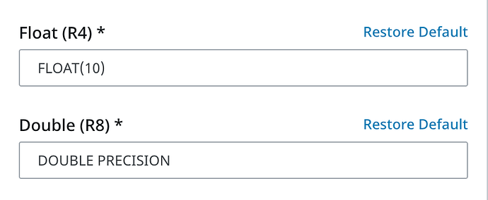

On the Connections \> Databases \> Settings page ([http://localhost:8088/app/connections/databases/settings/drivers-jdbc](http://localhost:8088/app/connections/databases/settings/drivers-jdbc)), what 'translator' is the MSSQL driver configured to use?
If you go to the 'Translators' tab ([http://localhost:8088/app/connections/databases/settings/translators](http://localhost:8088/app/connections/databases/settings/translators)), what values are listed in the 'Data Type Mapping' at the bottom of the MSSQL connection?
 ![image](https://us1.discourse-cdn.com/inductiveautomation/original/3X/6/b/6bf0a07005c4fe51f7aeb3724aca5a0517d7db23.png)

First of all, yes it was restored with the “disable” option checked.
The MSSQL driver configuration had no “translator” selected, which turned out to be because all translators were disabled. After enabling them and confirming they were correctly set in the “drivers-jdbc” settings for each driver, I restarted the gateway, and the partition table was created successfully.
