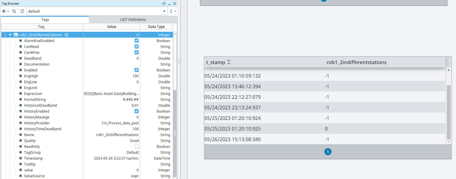

Hi together,
I created an expression tag and enabled the history function.
Sometimes it writes to the database, but sometimes not and I don't know why.
(I'm using Ignition 8.1.17)
Here is a screenshot, where you can see what I mean:
The tag "rob1\_2InDifferentStations" has the value 0 with the t\_stamp "Fri May 26 15:22:27 CEST 2023".
But at the table on the right side, which has a binding with the tag history of this tag,you see a "-1" as last value. How is this possible?
 ![image](https://us1.discourse-cdn.com/inductiveautomation/original/3X/7/f/7f77df6c087eb1434a8168adbd43c1023e336ca3.png)

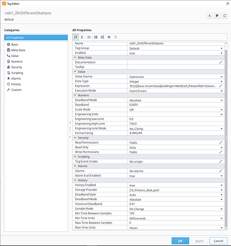

I already changed the "minimal time between samples" for the history function to 100ms, because I thought that maybe the changes are so to quick for the standard time of 1 second:
 ![image](https://us1.discourse-cdn.com/inductiveautomation/original/3X/b/2/b2efd856b98ab3a9c362ac0010978ba47dfb2bb7.png)
But as you see, the difference of timestamp of the last stored -1 and the timestamp of the actual value 0 is 9 minutes !!
Has anybody an idea, what is wrong with my history function?

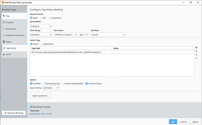

Could you show a picture of binding of the table?
Your **Max Time Between Samples** is 0, I don't understand why the data in your picture like this.
**Author:** ![Inken\_Kestler](https://avatars.discourse-cdn.com/v4/letter/i/bcef8e/32.png) [@Inken\_Kestler](https://forum.inductiveautomation.com/u/Inken_Kestler)\
**Post date:** [May 30, 2023, 8:57am UTC](https://forum.inductiveautomation.com/t/history-function-is-not-working/74280/3 "2023-05-30T08:57:25Z")
I changed the Min Time Between Samples, not the Max Time.
Here is the table binding:
