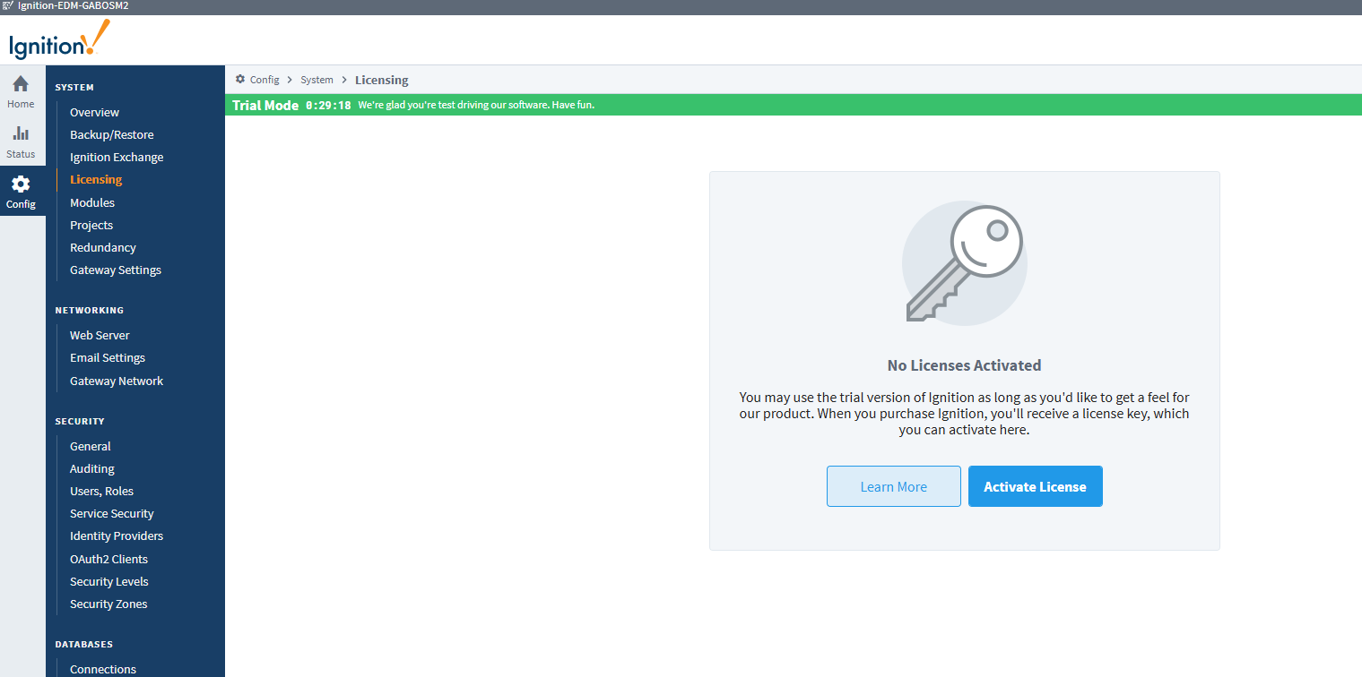

**Author:** ![gabosm](https://avatars.discourse-cdn.com/v4/letter/g/ecd19e/32.png) [@gabosm](https://forum.inductiveautomation.com/u/gabosm)\
**Post date:** [September 19, 2025, 4:56pm UTC](https://forum.inductiveautomation.com/t/history-manager-is-not-licensed-for-storage/110789/13 "2025-09-19T16:56:20Z")
There does not appear to be any licenses applied in that section due to being on the trial version:

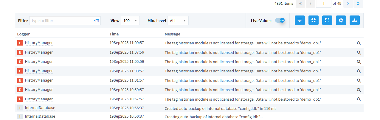

**Post date:** [September 19, 2025, 5:07pm UTC](https://forum.inductiveautomation.com/t/history-manager-is-not-licensed-for-storage/110789/14 "2025-09-19T17:07:04Z")
I also wanted to mention that I feel the database is configured correctly and running, because this licensing error is occurring every 2 minutes, which is the exact interval of change for the tag I am trying to shove in.

**Author:** ![Kurt.Larson](https://sea1.discourse-cdn.com/inductiveautomation/user_avatar/forum.inductiveautomation.com/kurt.larson/32/6426_2.png) [@Kurt.Larson](https://forum.inductiveautomation.com/u/Kurt.Larson)\
**Post date:** [September 19, 2025, 5:15pm UTC](https://forum.inductiveautomation.com/t/history-manager-is-not-licensed-for-storage/110789/15 "2025-09-19T17:15:01Z")
Just curious, have you tried restarting the Gateway? Everything so far seems to be matching up, and should allow for storage.
**Post date:** [September 19, 2025, 5:42pm UTC](https://forum.inductiveautomation.com/t/history-manager-is-not-licensed-for-storage/110789/16 "2025-09-19T17:42:40Z")
Reporting back that after restarting the gateway machine, the error was resolved, and there is now data from my LoRaWAN sensor read via MQTT being placed into the SQL Lite database. This is a bit odd, as the gateway machine was powered off overnight, and therefor restarted this morning. But regardless, things are now working and I have SQL tag access in the Power Chart. Thanks very much to everyone from the Ignition community for helping out so quickly!
