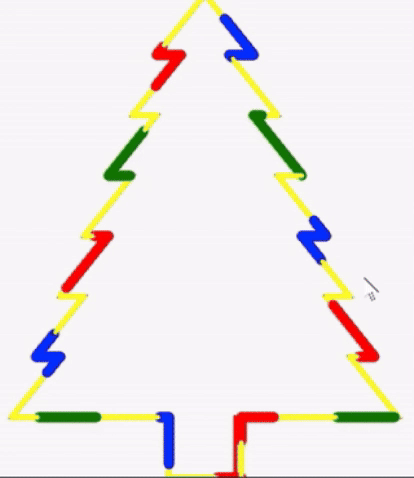

**Post date:** [December 9, 2025, 6:11pm UTC](https://forum.inductiveautomation.com/t/holiday-paintable-canvas-challenge/112691/3 "2025-12-09T18:11:08Z")
> [@paul-griffith](#):
> a procedurally generated tree
I've made Christmas trees before: 🙂 [Traced Christmas Tree Example](https://forum.inductiveautomation.com/t/get-all-the-vertices-from-a-general-path/100184/3)
![Traced Christmas Tree](https://us1.discourse-cdn.com/inductiveautomation/original/3X/2/c/2c482b178beb60f622645812c936d4cad91dbd7f.gif)
