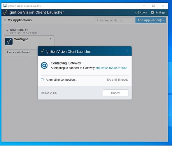

Hello, vision client stop working or lost connection on a remote PC. Keeps saying host unreachable but the host is running and I can ping it.
Any help would be great.
Thanks
David
 ![error](https://us1.discourse-cdn.com/inductiveautomation/original/3X/6/e/6eff3c033319656b15a32e0f9aef0319ca912146.jpeg)
 ![error2](https://us1.discourse-cdn.com/inductiveautomation/original/3X/b/e/bea87b57544f06bed69913770ddcaf720dedefb3.jpeg)
**Post date:** [January 15, 2021, 8:21pm UTC](https://forum.inductiveautomation.com/t/host-unreachable/42316/2 "2021-01-15T20:21:26Z")
Is the firewall on the igntion gateway running, and is port 8088 incoming allowed?
Can you connect to a client on the server itself?
**Author:** ![drinaldi](https://sea1.discourse-cdn.com/inductiveautomation/user_avatar/forum.inductiveautomation.com/drinaldi/32/32068_2.png) [@drinaldi](https://forum.inductiveautomation.com/u/drinaldi)\
**Post date:** [January 15, 2021, 8:28pm UTC](https://forum.inductiveautomation.com/t/host-unreachable/42316/3 "2021-01-15T20:28:04Z")
yes I can connect to client “on” the server.
this has been running for about 1 year, so maybe IT did some update and now the firewall is blocking it.
**Post date:** [January 15, 2021, 8:36pm UTC](https://forum.inductiveautomation.com/t/host-unreachable/42316/4 "2021-01-15T20:36:18Z")
it was firewall.
thank you!!!
