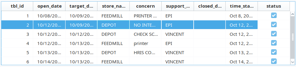

I want to get the ID of the selected rows in the power table using extension function (double click).
Reference:
 ![image](https://us1.discourse-cdn.com/inductiveautomation/original/3X/8/b/8be3eab7e19315c3c5e06287b95c625b0e1f26ab.png)
 ![image](https://us1.discourse-cdn.com/inductiveautomation/original/3X/e/4/e411dfb3f9b6c9e28ea494feeb880d3e061a50d4.png)
Thank you,

For a single row it should be something like this;
`ticketId = self.data.getValueAt(rowIndex,'tbl_id')`

Thanks sir 😀
