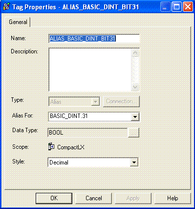

Currently there is no support in the ControlLogix driver for accessing bits of a DINT.
The solution to this is use an Alias tag in the ControlLogix and will work with other data types beside DINT. See the attached image for details of how to add an Alias tag.
 ![](https://us1.discourse-cdn.com/inductiveautomation/original/1X/028c6628ff6d184da2c5ebdf0436b31bdc9fdc90.GIF)

**Author:** ![ISDProj](https://avatars.discourse-cdn.com/v4/letter/i/58956e/32.png) [@ISDProj](https://forum.inductiveautomation.com/u/ISDProj)\
**Post date:** [March 25, 2010, 10:51pm UTC](https://forum.inductiveautomation.com/t/how-do-i-access-individual-bits-of-a-dint/1644/16 "2010-03-25T22:51:30Z")
OK, So it looks like “read OR Write” is how we are going to handle this… 😢
[quote]It’s not possible to do a safe/atomic write to a bit without native support from the driver/device.
[/quote]I assume that you are talking about the IA driver here, or is the “dot” notation an RSLinx only specialty?
**Post date:** [April 21, 2010, 1:20pm UTC](https://forum.inductiveautomation.com/t/how-do-i-access-individual-bits-of-a-dint/1644/20 "2010-04-21T13:20:42Z")
After some rather “lengthy” discussions with one of our resident PLC programmers I have managed to convince him to supply me with “BOOL” tags for the bits we need to control/read for this project. I’m relying on his expertise here as he states that this has consumed quite alot of extra PLC space (apparently a single BOOL consumes the same space as a DINT in a ControlLogix PLC?).
The arguments I put to him were:
1.) as we are unable to write an individual bit in a DINT we would need to do a read-OR-write.
2.) This would result in twice as much network traffic as a read is required prior to setting any given “bit” of the DINT & write back, and
3.) As the DINT forms part of a bi-directional control array (individual bits being allocated a given direction) we couldn’t guarantee that none of the remaining bits would be affected by the read-OR-write actions.
The long and short of this is we now have an interface that includes some 120 odd “BOOL” tags & around 240 DINT’s (repeated in 3 PLC’s at this site), so the urgency for the individual bit writing to a DINT has been reduced somewhat. Having said that, I’m sure that not all of our PLC programmers and/or hardware would be as accommodating (especially if PLC “space” is getting tight) so I still look forward to the “version” that includes this feature. ![8)](https://us1.discourse-cdn.com/inductiveautomation/original/1X/587d7fe0d6822f36e81815ab06aa7164e9d2e057.gif "Cool")
