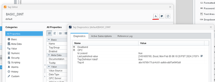

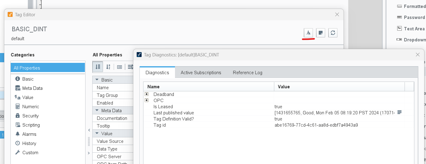

How do I tell if a tag is updating at the leased rate or the standard rate?
**Post date:** [February 5, 2024, 4:20pm UTC](https://forum.inductiveautomation.com/t/how-do-i-tell-what-rate-a-member-of-a-leased-tag-group-is-updating/85237/2 "2024-02-05T16:20:39Z")
You can look at the tag diagnostics to see if it's currently leased or not:
 ![image](https://us1.discourse-cdn.com/inductiveautomation/original/3X/7/d/7d467aeae2ebe8a1f929d1d20f07339001cfd40d.png)
