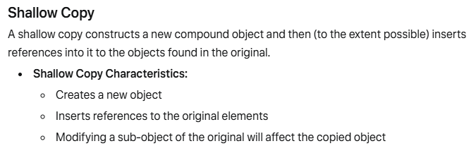

 ![image](https://us1.discourse-cdn.com/inductiveautomation/original/3X/2/6/2699ccf500fddaa2cca624efc5964fa1edbf824b.png)
Who would want to shallow copy.?!

Shallow copying is **much** cheaper, especially as object graphs get more complex. It's a reasonable default.
