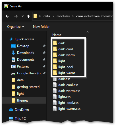

**Post date:** [August 10, 2025, 8:05pm UTC](https://forum.inductiveautomation.com/t/how-do-you-create-style-so-that-it-follows-theme/109562/2 "2025-08-10T20:05:49Z")
> [@Eugene49](#):
> the desired style objective
I'm not sure what this means, but in general try to use the [Perspective Built-In Themes | Ignition User Manual](https://docs.inductiveautomation.com/docs/8.1/ignition-modules/perspective/styles/perspective-built-in-themes). If you use the built-in theme colors such as `--success` or `--error` then they follow the colors as shown on the referenced page.
If you want to define your own then you need to add a custom theme for each of the built-in themes as described in [Creating and Using Custom Perspective Themes | Ignition User Manual](https://docs.inductiveautomation.com/docs/8.1/ignition-modules/perspective/styles/creating-and-using-custom-perspective-themes).
 ![image](https://us1.discourse-cdn.com/inductiveautomation/original/3X/9/2/92932a7adb3a14759a902b58cc155e578ac98131.png)
Note that you don't modify the stuff inside the folders. These get overwritten on each version upgrade. Read the doc!

**Post date:** [August 11, 2025, 1:13am UTC](https://forum.inductiveautomation.com/t/how-do-you-create-style-so-that-it-follows-theme/109562/4 "2025-08-11T01:13:47Z")
> [@Eugene49](#):
> if I hard code the font color to be darker
Don't hard code.
- Create a Style class that you will use on all similar components.
- Set the font color to a CSS variable such as `--neutral-20` or `--success`.1
- Set the background in the style class to `--neutral-90` (or whatever).
- Apply the style class to the component.
Now change your theme and watch the components change and retain high contrast.
Load an ignition page in your browser, hit F12 and scroll to the bottom of the CSS pane. There you will see all the theme color definitions.
