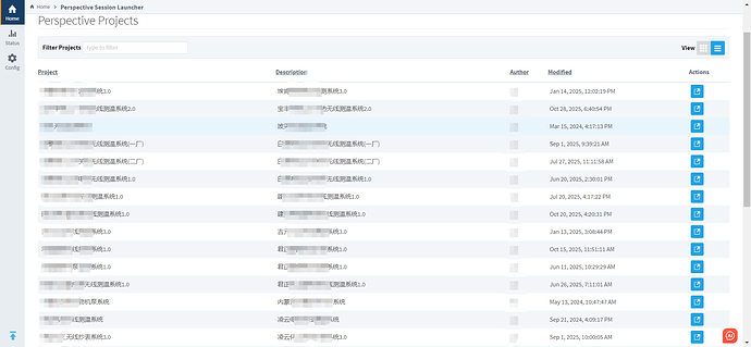

Hi,
我有十几个Project在运行，logs中的message我无法判断是哪个project产生的，无法定位到bug点.请问有什么办法可以查到吗？

Hovering the magnifying glass at the end of a log line should give you the project the error came from I think.

Yes as said before you can click on the mignifying glass and via the session-project you can find out which project generated the log. It also says from which exact user the message came.
Some errors don’t show the magnifying glass though, finding that error becomes much harder…

I would use this View path to designate what project it's from. If you have multiple projects repeating this View, I suggest refactoring and using a parent project for making future troubleshooting easier.

hank you for your reply. The magnifying glass will show the path of the view, but we still can't determine which project it is. Because my project has a similar path.

Here, only the view path can be displayed, but it is impossible to determine from which project it comes. If there are similar views in the project, it would be very difficult to make a distinction.

In your onMessageReceived scripts (or really any) using [system.util.getLogger | Ignition User Manual](https://docs.inductiveautomation.com/docs/8.1/appendix/scripting-functions/system-util/system-util-getLogger) could be helpful to improve the debugging output.

In the second screenshot the OP provided, you can see a logger called myLogger. Looks like they need to add more info to it.

Ah yeah, nice find. Using the sample code's logger name is not helpful ☹
