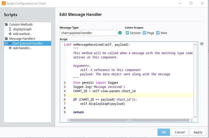

> Check that both the message being sent is scoped for session and that the Message Handlers are likewise listening at the session scope
Tried the three options scopes from message + handler script checkboxes: view, session, and page.
> [@cmallonee](#):

> [@cmallonee](#):
> as well as screenshots of the message handler script
 ![project_sc2](https://us1.discourse-cdn.com/inductiveautomation/original/3X/9/5/9519c3fb737830c11a71001f0316b7b9b9132c0b.jpeg)
> [@cmallonee](#):
> Are you putting the handler on the Embedded View, or on the components within the View which are embedded?
The handler is on the component (xychart) which is in a Column View (screenshot below) with other components. That column view is embedded within a view used in a popup.

Do you have any errors in your Gateway logs when you attempt to run this? I see that you’re logging when you attempt to broadcast, but that logging is done before the call is actually made, so I’m not confident your `sendMessage()` call is actually being completed successfully.
Please place a logging call immediately after the sendMessage invocation to verify it completed.
What all of this might boil down to is the View which would “hear” the broadcast MUST be in the DOM of the browser to hear the message. If your attempts to hide it from view are removing it from the DOM then it will not hear the message. Since you’re only modifying the visibility this might not be the cause as the View should still be present, but if the View has not loaded when the message has been broadcast, or if you are setting the view path after the fact then the View would not be in place to hear the message. Sorry, but I can’t verify if this is the case or not because your use-case is extremely complicated.
It’s sort of like when you call out in a house, but the person you’re talking to hasn’t walked in through the front door yet. The message was broadcast, but they weren’t around to hear it.

> [@cmallonee](#):
I solved the problem in adding a 10 second sleep `time.sleep(10)` before initializing the view with the broadcasting stuff. the onStartup method from the popupMainView is not the good place to broadcast. Indeed, the onStartup is executed before the popupMainView is ready!
edit: wait time to 1 sec is enough to get the PopUpView Ready to receive broadcast.

Right, so what looks like is occurring is the following sequence of events:
1. Click Event
1a. Action: open Popup
2. Popup onStartUp Event (note that the Embedded Views are not in place because this is the VERY first item executed, before even the Popup is displayed)
2a. Script Action (broadcast, but no Embedded Views exist to “hear” the broadcast)
3. Popup render
3a. THIS is where the Popup is built, and where the Embedded Views begin their existence
The introduction of a sleep within the onStartUp Event is allowing your setup to work because the onStartup Event (which contains the sleep) is on a different thread than that which handles the rendering. As a result, the rendering is occurring while your thread is sleeping.
A couple of options here:
1. Move the data being broadcast into custom session properties, and then bind the Embedded Views to those session properties.
2. Move the Popup content into a Docked View; Docked Views remain in the DOM even when the Docked View is collapsed (unless you have multiple docked views on a single side - then only the most recently opened docked view remains in the DOM).
