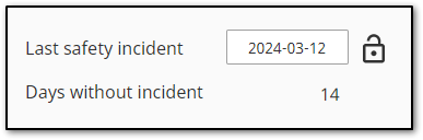

- Create a memory tag of data type DateTime.
- Create a Perspective view with a DateTime picker and a put a tag binding on the DateTime value property to your memory tag. Make it bidirectional so that the DateTime component can write to the tag. Set
`pickerType : date`
`format : YYYY-MM-DD`
(You should put some security on this page to restrict access to authorised users.)
- Anywhere you want to report the number of days since the last incident create a label on a view and put an expression binding on the text property. Something like,
`daysBetween({[default]LastIncident}, now(60000)`
`now(60000)` will cause the calculation to be run every 60 s.
I'll leave you to add some finesse to the expression to take care of partial days, etc.
Using a DateTime input rather than a Today button means you can enter a weekend day on Monday, etc.

This looks to be exactly what I needed. Now I'm going to make it even easier for me and figure out how to let someone else edit the start date so that EHS can enter a potential incident and it will update on its own.
