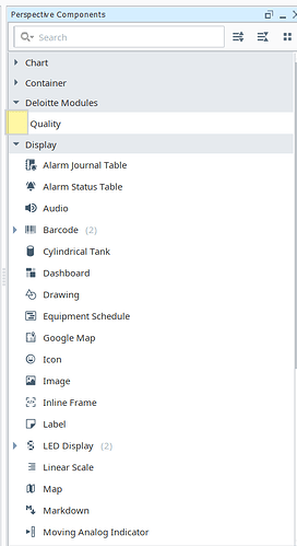

Hi Guys,
I just wondering on how to add icon on my custom perspective icon in the code. Assuming i already have created an icon and ready to used in the project, where to keep that icon inside my code folders.
 ![image](https://us1.discourse-cdn.com/inductiveautomation/original/3X/c/9/c921f1b24e3c44f41f673c408d03af90d96cc6a9.png)

Have a look a the ComponentDescriptor where you set the module properties. I got the icon working using the below line with the images stored in the resource folder, I think this was also in the example component from IA
```python
.setName("Image")
.setIcon(new ImageIcon(PerspectiveComponentsModule.class.getResource("/components/image/icons/image.png")))

Thanks for your response. It works.
