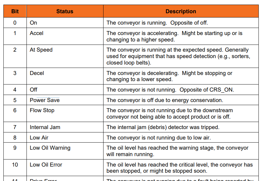

In order to know what each means, it is necessary to have vendor provided documentation. Here it maps out what each bit means. Those meanings can be built into a UDT.
 ![image](https://us1.discourse-cdn.com/inductiveautomation/original/3X/c/7/c707646d0210a9761fa231a41c186976e00388fb.png)
