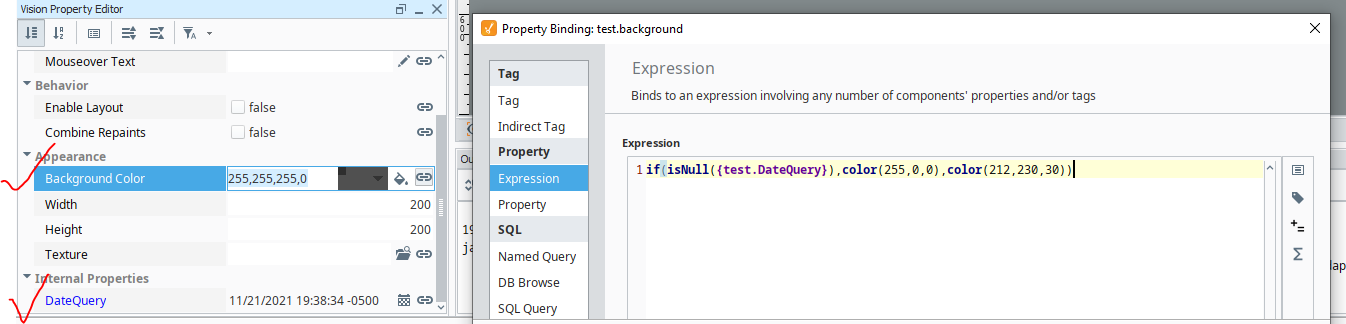

**Author:** ![pkhoshroo](https://sea1.discourse-cdn.com/inductiveautomation/user_avatar/forum.inductiveautomation.com/pkhoshroo/32/26801_2.png) [@pkhoshroo](https://forum.inductiveautomation.com/u/pkhoshroo)\
**Post date:** [November 21, 2021, 11:03pm UTC](https://forum.inductiveautomation.com/t/how-to-check-if-date-is-null-in-expression-language/53314/7 "2021-11-21T23:03:12Z")
Thank you very much, Dustin. Appreciate your help.
The thing is when my query returns no row I get an error.
“Named Query returned no rows on component”
Even though I turned on that overlayOPT option, I do still get the error.
If I want to be specific:
I have a named query with two parameters. I get those two parameters from two tags. If my query returns no row I want a color property to be red otherwise if it returns at least one row I want the color to be yellow.
Currently I am using this:
`if(isNull({test.DateQuery}),color(255,0,0),color(212,230,30))`
It returns the color yellow if we have rows but the red color comes in with an error since it returns no row.

**Post date:** [November 21, 2021, 11:25pm UTC](https://forum.inductiveautomation.com/t/how-to-check-if-date-is-null-in-expression-language/53314/10 "2021-11-21T23:25:35Z")
You are missing the color function name for the else value. Are you getting errors when you try to apply these expressions?
**Post date:** [November 21, 2021, 11:28pm UTC](https://forum.inductiveautomation.com/t/how-to-check-if-date-is-null-in-expression-language/53314/11 "2021-11-21T23:28:02Z")
> [@pkhoshroo](#):
> if(len(
Sorry that was a mistake from my side when I tried to copy. I do have the color function:
if(len({test.DateQuery}) !=1,color(255,0,0),color(212,230,30))
By having this expression I do not see any color change and also I get the error that:
I applied this code instead:
I do see the color changes however I still get that named query error and this on my component:
![image](https://us1.discourse-cdn.com/inductiveautomation/original/3X/2/e/2e64d88eff0c71a1c031d86a8dab60df71382dcd.png)
**Post date:** [November 21, 2021, 11:31pm UTC](https://forum.inductiveautomation.com/t/how-to-check-if-date-is-null-in-expression-language/53314/12 "2021-11-21T23:31:10Z")
Show your property inspector where {test.DateQuery} is bound. Can you open the dataset viewer there to see the output from your named query?

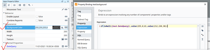

**Post date:** [November 22, 2021, 12:46am UTC](https://forum.inductiveautomation.com/t/how-to-check-if-date-is-null-in-expression-language/53314/13 "2021-11-22T00:46:45Z")
This is what I am doing. I have a template called “test” and I have a named query with two parameters and I get the value of the parameters from two memory tags.
The template has an internal property called DateQuery and its data is bound to that named query.
I have the expression on the background color of my template. The DateQuery can return multiple rows or no rows.
 ![image](https://us1.discourse-cdn.com/inductiveautomation/original/3X/b/7/b73e71d9cbeff1fb806f063d72139b064c9c13f4.png)
I did not quite understand what you mean by dataset viewer.
**Post date:** [November 22, 2021, 12:53am UTC](https://forum.inductiveautomation.com/t/how-to-check-if-date-is-null-in-expression-language/53314/14 "2021-11-22T00:53:58Z")
Your DateQuery property is a date–I was expecting it to be a dataset. Show your binding for DateQuery.
**Post date:** [November 22, 2021, 1:04am UTC](https://forum.inductiveautomation.com/t/how-to-check-if-date-is-null-in-expression-language/53314/15 "2021-11-22T01:04:45Z")
you are correct, I changed the date to be dataset and I user len() in my expression instead of isNull but it did not work.
This is the binding on the named query.
I get the correct value on my named query. However, my problem is with when the named query returns no row.
 ![image](https://us1.discourse-cdn.com/inductiveautomation/original/3X/0/4/043ca96658d14ace3183cfdaabba580000110f4c.png)
**Post date:** [November 22, 2021, 1:13am UTC](https://forum.inductiveautomation.com/t/how-to-check-if-date-is-null-in-expression-language/53314/16 "2021-11-22T01:13:04Z")
I got it working. It seems that I had a syntax error in my code. but it is fixed now. Thank you everyone

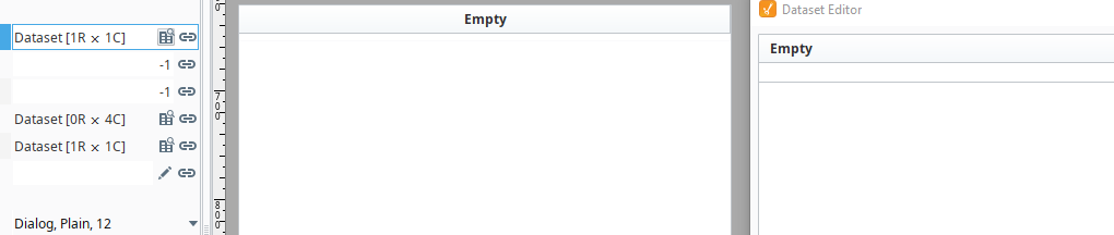

Yes, This Works but I am getting a result where length of the Dataset is 1 but it doesnt holds any value, so here how can we check? If I am checking with isNull its not giving the proper result as well
**Author:** ![justinedwards.jle](https://sea1.discourse-cdn.com/inductiveautomation/user_avatar/forum.inductiveautomation.com/justinedwards.jle/32/37854_2.png) [@justinedwards.jle](https://forum.inductiveautomation.com/u/justinedwards.jle)\
**Post date:** [January 15, 2023, 6:33am UTC](https://forum.inductiveautomation.com/t/how-to-check-if-date-is-null-in-expression-language/53314/20 "2023-01-15T06:33:04Z")
> [@Sayantan\_Chatterjee](#):
You could add indexing to check the length of specific elements in the dataset
Example:
 ![image](https://us1.discourse-cdn.com/inductiveautomation/original/3X/0/9/09acbbc283c661d6bb6993822730198d35a71ccd.png)
`len({Root Container.Power Table.data})` will produce a value of 1 because the length of the dataset is one element, but if I spot check the first row of the first column by adding brackets to the end of the expression, I will get a value of zero because there is no actual value at [row 0, column 0]: `len({Root Container.Power Table.data}[0,0])
