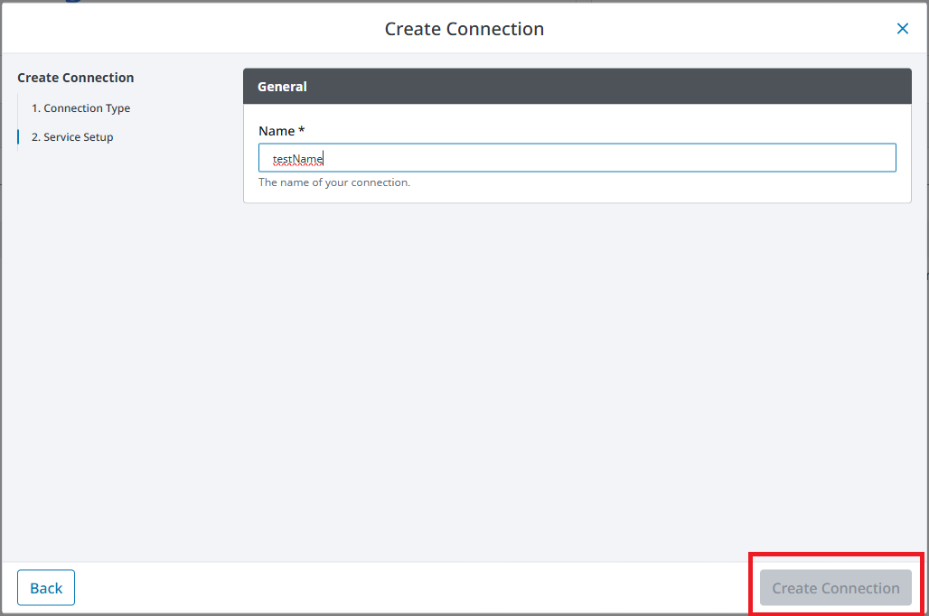

I’m creating a new service connection type by extending the ServiceConnectorExtensionPoint Object. I’m creating a react component for the form. My question is how to enable the “Create Connection” button on the service connection modal? I only want it to be enabled when all form validations have passed. I’m using the ignition react packages. Here are a couple examples of my code and a screenshot. Thanks in advance!

#### Screenshot
 ![image](https://us1.discourse-cdn.com/inductiveautomation/original/3X/f/8/f8e0b873e59cde8e38fb72900d335f082a3c56c4.png)
