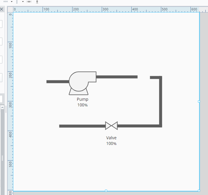

Examples of mis-alignment:
Designer (ok) :
 ![image](https://us1.discourse-cdn.com/inductiveautomation/original/3X/a/6/a62017841ee4adff26874ac2f28b2ece4f8fd807.png)

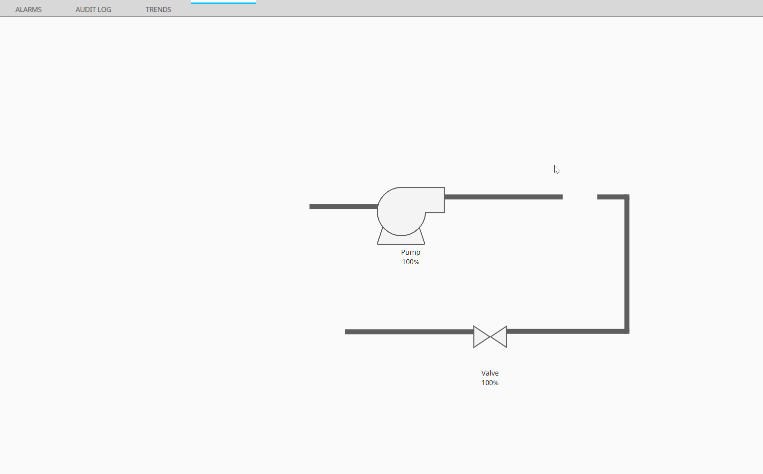

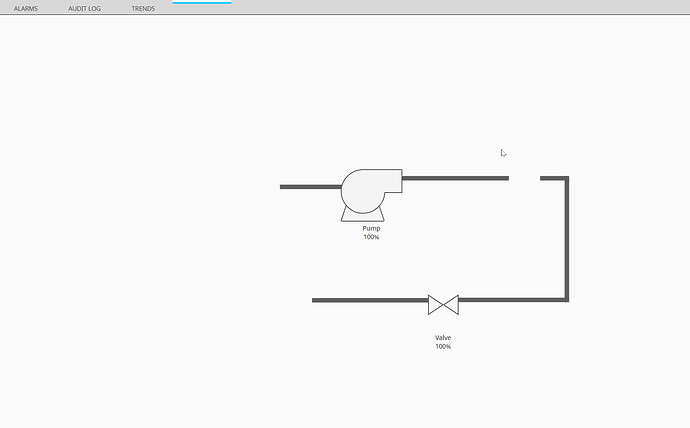

Browser (note the pipes misalignment):
 ![image](https://us1.discourse-cdn.com/inductiveautomation/original/3X/6/8/6804436f104a8d1c2e0689d13dcdc4c36df7f564.png)
The View is a coord view and mode set to percent with the aspect ratio configured as the default size width:height

The issue is that the root of the symbols are flex containers, and the symbol scales differently to how the text scales.
