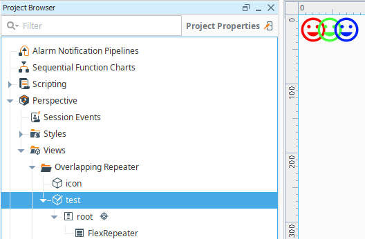

You can use `overflow: visible` to achieve this:
 ![image](https://us1.discourse-cdn.com/inductiveautomation/original/3X/8/9/89a525d98974abac1f7f7332b633623a07b1ec2b.png)
Repeater:

Embedded icon:
