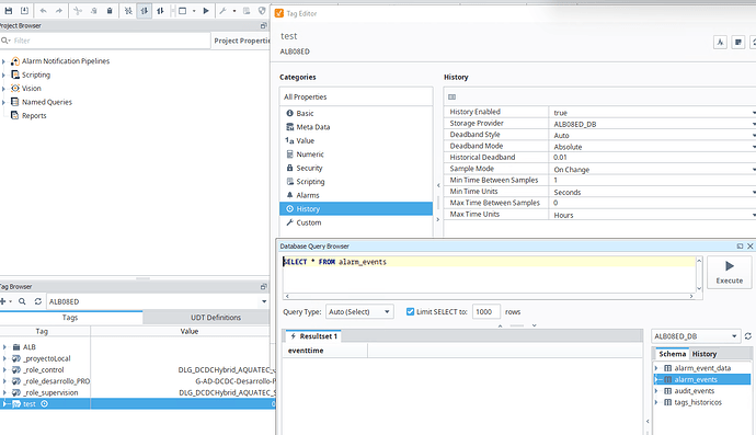

Hi,
I have a project with a remote tag provider ALB08ED with tags configured to use the history provider ALB08ED\_DB.
 ![image](https://us1.discourse-cdn.com/inductiveautomation/original/3X/9/5/959d498d685e2ac89310d436864a0dc7fc0bd080.png)
![image](https://us1.discourse-cdn.com/inductiveautomation/original/3X/9/1/918de05cb38f61f6997a91170e58111a673593ab.png)
The database connection status is "Valid" and is named ALB08ED\_DB, but it has not automatically generated the Ignition Auto-Generated Tables (sqlth\_te, sqlth\_scinfo, ...).
 ![image](https://us1.discourse-cdn.com/inductiveautomation/original/3X/3/8/386d8ed4231d5823b5de596bc3d52afe13924e32.png)
Is there any way to force the creation of the tables?

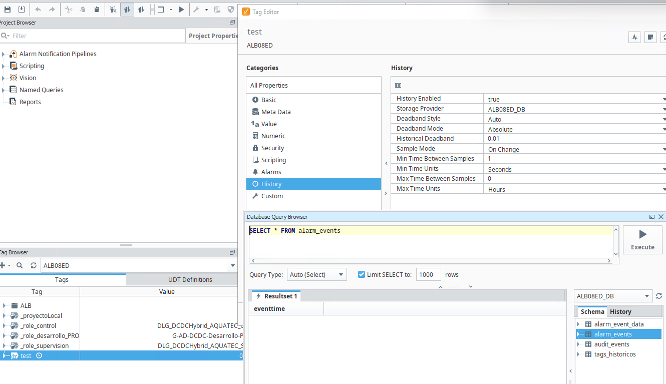

**Author:** ![Jesus\_Mariano\_Moreno](https://avatars.discourse-cdn.com/v4/letter/j/57b2e6/32.png) [@Jesus\_Mariano\_Moreno](https://forum.inductiveautomation.com/u/Jesus_Mariano_Moreno)\
**Post date:** [November 3, 2025, 3:00pm UTC](https://forum.inductiveautomation.com/t/how-to-create-sqlth-te-manualy/111891/3 "2025-11-03T15:00:54Z")
I have created It, but it doesn’t work,
 ![image](https://us1.discourse-cdn.com/inductiveautomation/original/3X/4/c/4c80f19d38bacbe600de677fe3f966b26745112c.png)
Any other idea?

**Author:** ![MMaynard](https://sea1.discourse-cdn.com/inductiveautomation/user_avatar/forum.inductiveautomation.com/mmaynard/32/3366_2.png) [@MMaynard](https://forum.inductiveautomation.com/u/MMaynard)\
**Post date:** [November 3, 2025, 3:31pm UTC](https://forum.inductiveautomation.com/t/how-to-create-sqlth-te-manualy/111891/5 "2025-11-03T15:31:17Z")
Change the expression on the tag to be
`getSecond(now(1000))`
It needs to see a tag value change I believe.
If it still doesn’t work, go to the gateway web page, status, logs and see if there are any database errors?
**Post date:** [November 4, 2025, 11:23am UTC](https://forum.inductiveautomation.com/t/how-to-create-sqlth-te-manualy/111891/9 "2025-11-04T11:23:33Z")
Thank you for your help,
Finally, it was a configuration problem in the remote gateway where the datasync was unconfigured and tag writing was not allowed in the service security.
