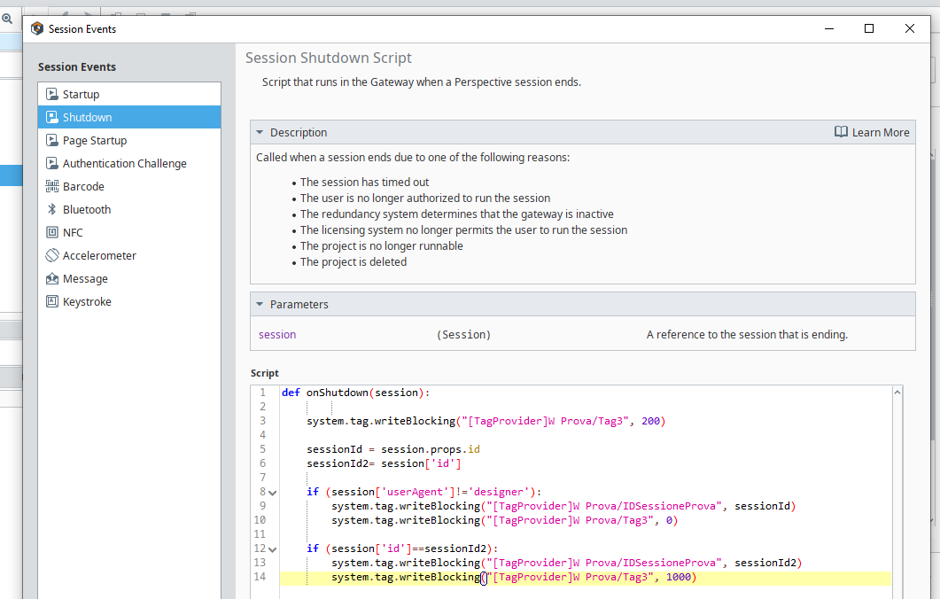

Dear all,
I would like to identify when a Perspective session (web page or app) starts up and shuts down.
My goal is to write to a tag when the session starts and when it ends.
I’ve tried using the session startup and shutdown events, but my script doesn’t seem to work.
Has anyone successfully used session startup or shutdown events in Perspective?
Any suggestions or examples would be greatly appreciated!

Nope, i don't see the logfile. I try to write a memory tag to control the events:

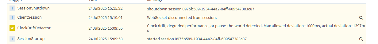

**Author:** ![Sara](https://avatars.discourse-cdn.com/v4/letter/s/a5b964/32.png) [@Sara](https://forum.inductiveautomation.com/u/Sara)\
**Post date:** [July 24, 2025, 8:53am UTC](https://forum.inductiveautomation.com/t/how-to-detect-session-startup-and-shutdown-in-ignition-perspective/108875/9 "2025-07-24T08:53:35Z")
Apologies for the confusion — my end goal is to write to a specific tag when a particular session is closed. I tried several if instructions but the ones I really need don't work
 ![Screenshot 2025-07-24 115414](https://us1.discourse-cdn.com/inductiveautomation/original/3X/4/a/4a6881e967d6b2ecf3c835664f7ccd99eae9e564.png)
**Post date:** [July 24, 2025, 10:40am UTC](https://forum.inductiveautomation.com/t/how-to-detect-session-startup-and-shutdown-in-ignition-perspective/108875/10 "2025-07-24T10:40:10Z")
Are you sure the session had closed when you checked? Have a look in the status page of the Web portal at the perspective sessions running. A session does not end simply when you close the browser tab running a client. After that it waits for the session timeout before the session running in the gateway shuts down
**Post date:** [July 24, 2025, 12:41pm UTC](https://forum.inductiveautomation.com/t/how-to-detect-session-startup-and-shutdown-in-ignition-perspective/108875/11 "2025-07-24T12:41:56Z")
Yes, you are right but I'm sure of the closed session, i see the log view and there are all the session, and when the script doesn't work.

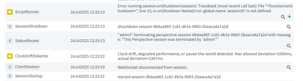

 ![Screenshot 2025-07-24 142401](https://us1.discourse-cdn.com/inductiveautomation/original/3X/8/1/8150c88ef583cda9784c3065cf3691047864d44e.png)
**Post date:** [July 24, 2025, 12:45pm UTC](https://forum.inductiveautomation.com/t/how-to-detect-session-startup-and-shutdown-in-ignition-perspective/108875/12 "2025-07-24T12:45:01Z")
~~Nick's point is that closing a browser tab, or closing the browser entirely, **does not end** the session. Browsers don't tell webservers when they close, so the gateway **cannot** close the session immediately. It has to time out.~~
~~Your desire to act on session close is misguided/impractical. Find another way. (Share **why** you think you need this.)~~
Your script has a syntax error. Case-sensitive variable name, it seems.

**Author:** ![dkhayes117](https://sea1.discourse-cdn.com/inductiveautomation/user_avatar/forum.inductiveautomation.com/dkhayes117/32/68344_2.png) [@dkhayes117](https://forum.inductiveautomation.com/u/dkhayes117)\
**Post date:** [July 24, 2025, 12:58pm UTC](https://forum.inductiveautomation.com/t/how-to-detect-session-startup-and-shutdown-in-ignition-perspective/108875/16 "2025-07-24T12:58:34Z")
I think he is talking about `sessionID` vs `sessionId`, it's commented out.
**Post date:** [July 24, 2025, 1:02pm UTC](https://forum.inductiveautomation.com/t/how-to-detect-session-startup-and-shutdown-in-ignition-perspective/108875/17 "2025-07-24T13:02:24Z")
> [@dkhayes117](#):
> it's commented out.
To get that logged error, a similar usage must have been present.
**Post date:** [July 24, 2025, 1:04pm UTC](https://forum.inductiveautomation.com/t/how-to-detect-session-startup-and-shutdown-in-ignition-perspective/108875/18 "2025-07-24T13:04:36Z")
Right, and it is commented as `this line doesn't work`. I was just pointing Nick where to look.
**Post date:** [July 24, 2025, 1:22pm UTC](https://forum.inductiveautomation.com/t/how-to-detect-session-startup-and-shutdown-in-ignition-perspective/108875/19 "2025-07-24T13:22:25Z")
ok i correct the second one sessionId, but the if instruction doesn't work
 ![Screenshot 2025-07-24 151732](https://us1.discourse-cdn.com/inductiveautomation/original/3X/0/1/01155e106cb30420ce84362425b9d8006110b8c6.png)
 ![Screenshot 2025-07-24 151900](https://us1.discourse-cdn.com/inductiveautomation/original/3X/e/4/e45c84624c08d852a830ad60ca55c5d0b52c3ff2.png)
now my test tag values 200. but if it works well would value 1000
**Post date:** [July 24, 2025, 11:13pm UTC](https://forum.inductiveautomation.com/t/how-to-detect-session-startup-and-shutdown-in-ignition-perspective/108875/20 "2025-07-24T23:13:45Z")
To answer _why_ your script isn't working though: when the shutdown event fires, the session is _already gone_, so `getSessionInfo` doesn't contain the session anymore
Going back a step though, with the actual code you've got, it seems superfluous to be looping through the sessions _at all_, when at the end of it all it's doing is writing the session id to a tag. Can't you just skip the loop and just write the session.props.id to the tag? Unless of course there's some other logic you want to do that you haven't shown.
