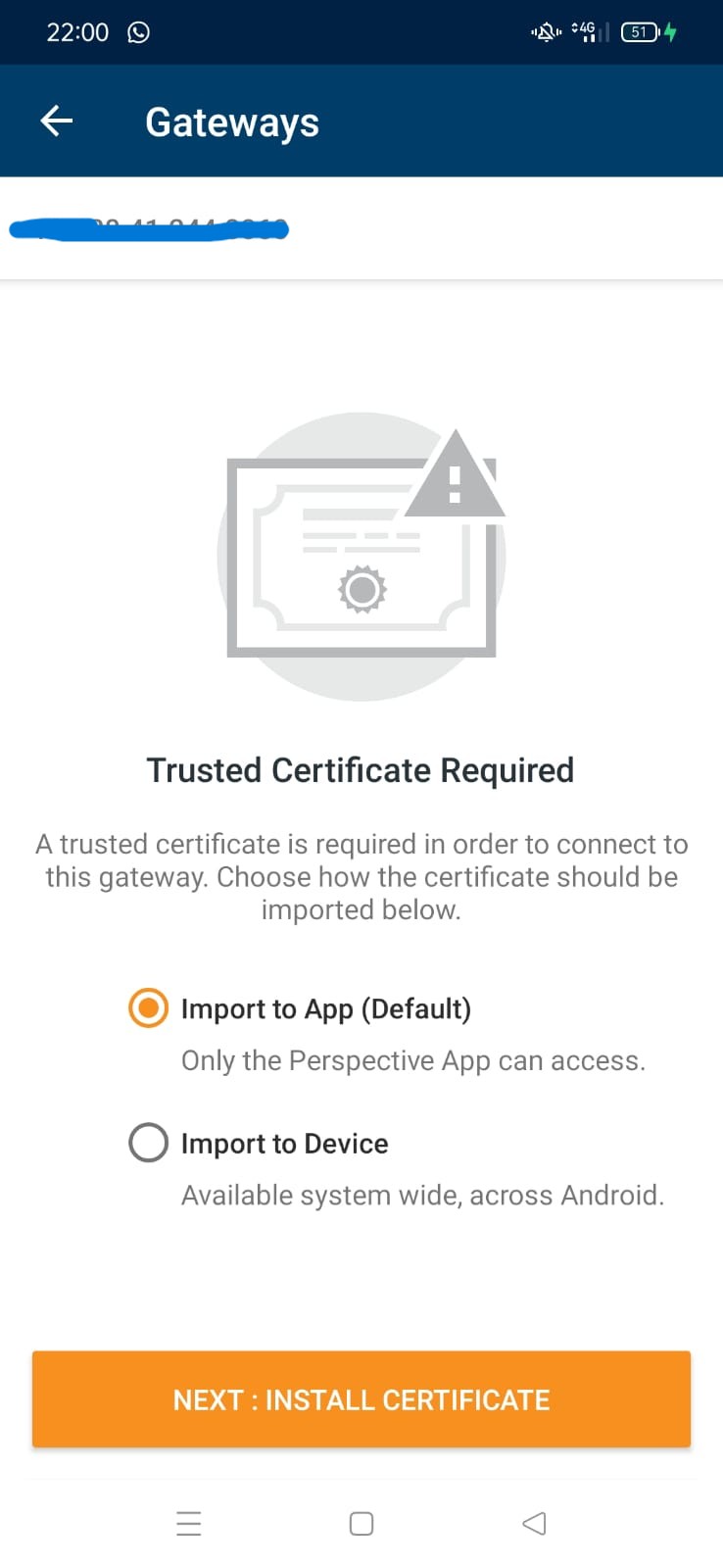

**Post date:** [February 3, 2026, 6:00pm UTC](https://forum.inductiveautomation.com/t/how-to-display-an-ignition-project-from-a-computer-to-a-smartphone/113723/3 "2026-02-03T18:00:44Z")
![gateway ignition](https://us1.discourse-cdn.com/inductiveautomation/original/3X/d/8/d8f541f73ecd04f48a7e36b7b301106440ff2f26.jpeg)
 ![gateway ignition 01](https://us1.discourse-cdn.com/inductiveautomation/original/3X/5/f/5f8b8c06ff01c21cb64e73782208364fb207b05c.jpeg)
I am trying to access my project that is on my computer from the Ignition Perspective app on my smartphone. Is it necessary to add a CA-signed Security Certificate?
**Post date:** [February 3, 2026, 6:06pm UTC](https://forum.inductiveautomation.com/t/how-to-display-an-ignition-project-from-a-computer-to-a-smartphone/113723/4 "2026-02-03T18:06:18Z")
> [@rizkynurrohim06](#):
It is highly recommended if you are connecting through the public internet. But many of my clients use private Certificate Authorities, and add them to the device.
