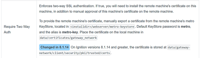

Good Day IA Community:
I am trying to enable two-way SSL authentication between master and backup sever. I am confused as to the format type I should export the certificate.
According to the user manual:
 ![image](https://us1.discourse-cdn.com/inductiveautomation/original/3X/b/5/b597da2e861404776f1dcaaed3891237d55df5c0.png)
It seems like an easy process. I am using KeyStore Explorer to export the metro-key but confused as to the export format to use and also if there are any more steps to do after copying it to the file path as stated in the user manual and also enabling "Require Two Way Auth" in the gateway.
 ![image](https://us1.discourse-cdn.com/inductiveautomation/original/3X/9/9/99255b01c6dc1d8bc88343ba6d67702cd87c9f27.png)
Please assist
Thank You
**Author:** ![raees.khan](https://sea1.discourse-cdn.com/inductiveautomation/user_avatar/forum.inductiveautomation.com/raees.khan/32/76218_2.png) [@raees.khan](https://forum.inductiveautomation.com/u/raees.khan)\
**Post date:** [July 31, 2025, 9:28pm UTC](https://forum.inductiveautomation.com/t/how-to-enable-two-way-ssl-authentication-between-master-and-backup-server/108934/2 "2025-07-31T21:28:26Z")
# 🔐 Enabling Two-Way Authentication on a Redundant Pair
## Step 1: Backup Both Gateways
Create Ignition Gateway backups before making any changes.
- Go to Config \> Backup/Restore
- Click **Download Backup**
## Step 2: Export SSL Certificates
Run the following commands on each machine to export the SSL certificate:
**Windows:**
"C:\Program Files\Inductive Automation\Ignition\lib\runtime\jre-win\bin\keytool.exe" ^
 -exportcert -keystore "C:\Program Files\Inductive Automation\Ignition\webserver\metro-keystore" ^
 -alias metro-key -file remote-gateway-cert.cer -storepass metro
**Linux:**
cd /usr/local/bin/ignition/lib/runtime/jre-nix/ &&
keytool -exportcert -keystore /usr/local/bin/ignition/webserver/metro-keystore \
You can rename `remote-gateway-cert.cer` to something meaningful, like `project-001.cer`.
## Step 3: Distribute Certificates
Copy both certificate files to this directory on both machines:
`<installdir>/data/gateway-network/client/security/pki/trusted/certs`
This ensures redundancy during failover or re-sync operations.
## Step 4: Enable Two-Way Authentication
- On the **Master Gateway** , go to: `Config > Networking > Gateway Network`
- Enable **Require Two Way Auth**
- Click **Save Changes** at the bottom
The connection may briefly disconnect but should auto-recover.
## ✅ Step 5: Success!
Two-way authentication is now active between your Master and Backup Gateways.
