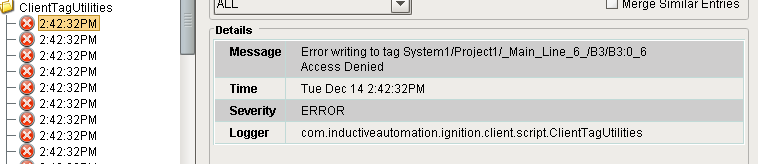

Every time this projects starts some errors show up. I pictured the log of one below.
 ![startuplog](https://us1.discourse-cdn.com/inductiveautomation/original/3X/8/6/862f59789a70c5855f0b2ba6a0dad132f2edd199.png)
But I don’t know what this is coming from, or what is attempting to access it? How do I sniff this out?
Thank you in advance!
**Post date:** [December 15, 2021, 12:20pm UTC](https://forum.inductiveautomation.com/t/how-to-find-clientutilities-tag-error/54124/2 "2021-12-15T12:20:20Z")
It is a `system.tag.write.....()` function call in a script. Look in your startup events. Look in all of the scripts in the windows that auto-start in that project.

@pturmel that was enough to point me in the right direction for this and another question I posted.
It only opens to two windows. But there were many other windows set to open on startup. I disabled them all but the two needed.
