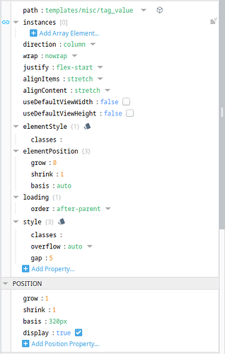

How can I make a Flex Repeater Items adjust to the size of each instance, but make them appear out of the screen and make a scroll appear.
My current config:

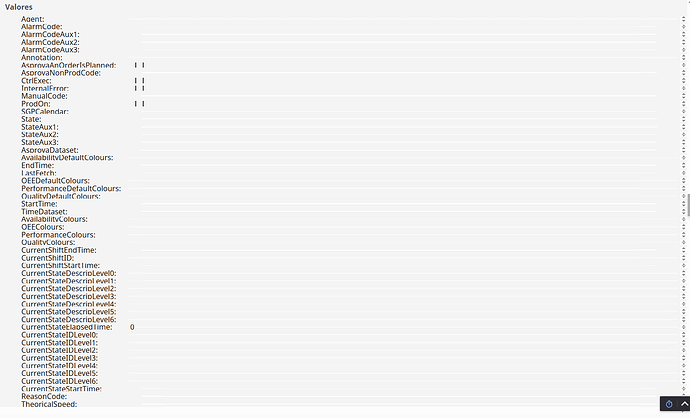

What I mean is this:
 ![{35307354-048A-4CBD-87FC-3FB2C13608CB}](https://us1.discourse-cdn.com/inductiveautomation/original/3X/e/d/ed2f4e81fa2fb206eea8af8e63cb8c1688f61425.png)

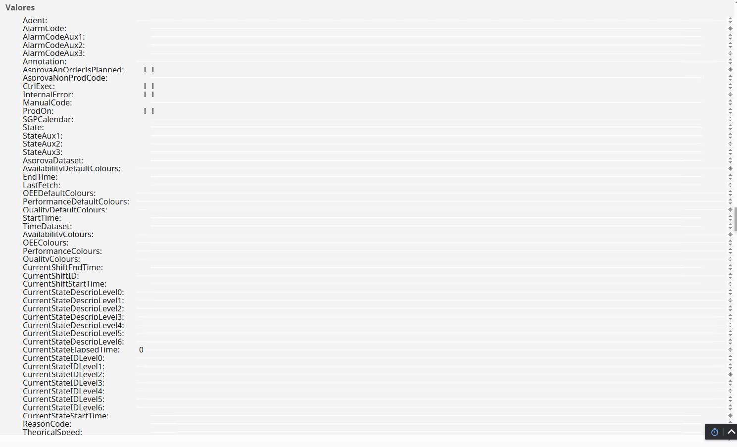

But If there are too many selected:
 ![{AF5739A0-13E2-4DD8-A595-FDF137855E05}](https://us1.discourse-cdn.com/inductiveautomation/original/3X/1/4/142e0af2cfe708db95ebe599233e62a1f3dd7c58.png)
How could I make a scroll appear but also that the size is adjusted to the size of each instance?
Thx!

Note: Tags references are picked up from a Tag Tree Component
**Author:** ![Samuel\_Sueur](https://avatars.discourse-cdn.com/v4/letter/s/e36b37/32.png) [@Samuel\_Sueur](https://forum.inductiveautomation.com/u/Samuel_Sueur)\
**Post date:** [October 30, 2025, 11:07am UTC](https://forum.inductiveautomation.com/t/how-to-make-a-flexrepeater-have-a-scroll-bar/111815/2 "2025-10-30T11:07:10Z")
I think just specifying
```python
"shrink" : 0
in your elementPosition properties should do the trick?
**Author:** ![danielps1818](https://avatars.discourse-cdn.com/v4/letter/d/ecae2f/32.png) [@danielps1818](https://forum.inductiveautomation.com/u/danielps1818)\
**Post date:** [October 30, 2025, 11:08am UTC](https://forum.inductiveautomation.com/t/how-to-make-a-flexrepeater-have-a-scroll-bar/111815/3 "2025-10-30T11:08:08Z")
Yep, it totally did.
Thank you!
**Author:** ![tgarrison](https://sea1.discourse-cdn.com/inductiveautomation/user_avatar/forum.inductiveautomation.com/tgarrison/32/80965_2.png) [@tgarrison](https://forum.inductiveautomation.com/u/tgarrison)\
**Post date:** [October 30, 2025, 12:27pm UTC](https://forum.inductiveautomation.com/t/how-to-make-a-flexrepeater-have-a-scroll-bar/111815/4 "2025-10-30T12:27:55Z")
Also, the styles/overflow setting. You can force the scrollbar to be present at all times if you want so it doesn’t come and go..
