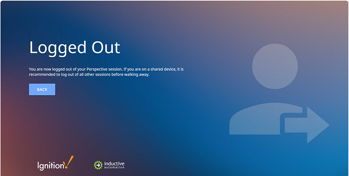

I have removed my custom login page and now i am using the default ignition idp and ignition login. I can navigate between pages of different project. But now i have problem in the log out. When i navigate to other project and od the log out using system.perspective.logout() my session is getting logged out for that project only not the main project from where i am navigating to the second project. Also when i click on back to go to login page again when i log in the page from the second project from where i had logged out is opening again as it was the url i had at the time of logout.
The behavior i want is that i have one main project where i have home page to navigate to other projects. So when user log out from any project whether it main or other projects. all project session should be logged out and when user try to log back by clicking back to get to login page then after login the home page of main project should open.
My apologies if i am not able to explain my situation correctly please let me know if the explanation is not good enough. Thanks again for all the help here.
