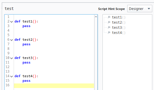

How can I create hyperlinks in a python file?
Normally whenever you create a function one is created automatically.
> **Image 1**
> ![image](https://us1.discourse-cdn.com/inductiveautomation/original/3X/2/4/24e38b6dd477b82eaba639a9c07e727ec5b30d22.png)
However I have a file that doesn't contain any function, only information:
> **Image 2**
> ![image](https://us1.discourse-cdn.com/inductiveautomation/original/3X/b/8/b87f9b78496cd7042cc7ffe4142ed23a62a334fb.png)
**How could I create hyperlinks so I don't have to scroll down** and I can simply click to go there?
I thought about doing this:
`def info1(): return`
but is a bit _ugly_...
Thx in advance!
**Post date:** [September 30, 2025, 12:05pm UTC](https://forum.inductiveautomation.com/t/how-to-place-hyperlinks-in-a-python-file/111090/2 "2025-09-30T12:05:43Z")
You cannot.
**Author:** ![danielps1818](https://avatars.discourse-cdn.com/v4/letter/d/ecae2f/32.png) [@danielps1818](https://forum.inductiveautomation.com/u/danielps1818)\
**Post date:** [September 30, 2025, 12:41pm UTC](https://forum.inductiveautomation.com/t/how-to-place-hyperlinks-in-a-python-file/111090/3 "2025-09-30T12:41:58Z")
**Post date:** [September 30, 2025, 3:57pm UTC](https://forum.inductiveautomation.com/t/how-to-place-hyperlinks-in-a-python-file/111090/4 "2025-09-30T15:57:19Z")
In some version of 8.3 I'm hoping to revamp this tree from its current (quite fragile) regex parsing methodology to a proper AST parse, which would make it trivial to add support for declared constants. Probably only at the top level.
