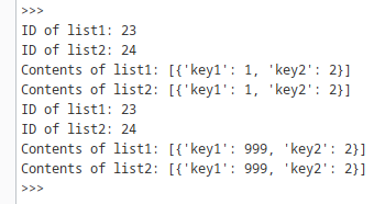

I’ve been having trouble with a script and I isolated the issue to the fact that my for loops are somehow modifying an unrelated list (as far as I can tell). I replicated the result with this piece of code:
```python
list1 = [{"key1": 1, "key2": 2}]
list2 = list(list1)
print "ID of list1: " + str(id(list1))
print "ID of list2: " + str(id(list2))
print "Contents of list1: " + str(list1)
print "Contents of list2: " + str(list2)
list2[0]["key1"] = 999
It returns this:
 ![image](https://us1.discourse-cdn.com/inductiveautomation/original/3X/c/5/c5e6d1b3d277a58e2df26b0fb92fe14d1e96ad6f.png)
This makes absolutely no sense to me, because the IDs of the lists are different, but the code modifying list2 somehow also modifies list1…

I think it has to do with deep vs shallow copying. I only know this because I ran into a very similar situation earlier this year.
When you say `list2 = list1`, `list2` is a reference to `list1`, so any changes you make to `list1` will also modify `list2`.

Thanks for the reply. That’s what I though at first as well, but I’m not simply doing list2 = list1. But rather list2 = list(list1) which doesn’t copy the reference, but actually makes another list.
The IDs of both lists are different in the above example, so the code should be referencing different lists.

Actually, it makes a different list containing different references to the same elements.
The key thing here is that your list contains references, not values. When copying the list, even if it’s a brand new one, the things inside still reference the same things.
Imagine copying a list of pointers. You end up with 2 different lists, that contain different pointers, but that point to the same place. Now, if you tried `list2[0] = '999'`, that won’t change `list1[0]`, only assign 999 to `list2[0]`.
BUT, `list2[0][0] = 999` WILL modify the thing that was pointed at by both `list1[0]` and `list2[0]`.
If you look back at your first code snippet, you’ll see you’re using `list2[0]['key1'] = 999`. You’re not modifying the first element of list2, you’re modifying the object referenced by the first element of list2. Which happens to also be referenced by the first element of list1.
