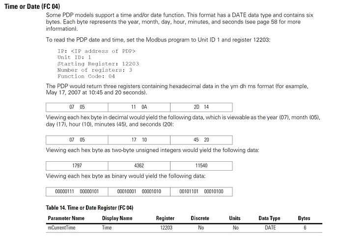

I found this, not sure if they are correct?
 ![DateTime](https://us1.discourse-cdn.com/inductiveautomation/original/3X/f/9/f9ccc6e02b3401654b881e0476be462c17657068.jpeg)
 ![DateTime2](https://us1.discourse-cdn.com/inductiveautomation/original/3X/5/4/541f38f80c5531d9ab2db46f5b00b0825244e49f.jpeg)
**Author:** ![Billy\_Elliott](https://avatars.discourse-cdn.com/v4/letter/b/c37758/32.png) [@Billy\_Elliott](https://forum.inductiveautomation.com/u/Billy_Elliott)\
**Post date:** [September 7, 2022, 6:59pm UTC](https://forum.inductiveautomation.com/t/how-to-read-48-bit-3-words-via-modbus-into-a-tag/63802/16 "2022-09-07T18:59:32Z")
Those are two different manuals. I appreciate the help!

No it’s a Gateway card for a Eaton Power Xpert Meter 2260, but the card is really just a network card. I found another manual that gives another description.
 ![DateTime3](https://us1.discourse-cdn.com/inductiveautomation/original/3X/9/8/98fb61ba5ee08d10276115c0595666684e5d53fa.jpeg)
I guess the short answer is I will have to read it in as 3 seperate registers to get the data in and then decode it. I’m just not very good at slicing and dicing the registers once I get them in.
**Post date:** [September 8, 2022, 2:16pm UTC](https://forum.inductiveautomation.com/t/how-to-read-48-bit-3-words-via-modbus-into-a-tag/63802/19 "2022-09-08T14:16:28Z")
It doesn’t look like the values you read match that format 😕
You read:
```auto
00 00 01 01 00 00
which would mean, according to these docs:
```auto
Y=00
M=00
D=01
H=01
M=00
S=00
It seems… shifted by one byte, assuming the date value you gave us (2000-01-01T00:00:00Z) is correct.
**Post date:** [September 8, 2022, 2:26pm UTC](https://forum.inductiveautomation.com/t/how-to-read-48-bit-3-words-via-modbus-into-a-tag/63802/20 "2022-09-08T14:26:58Z")
The latest document has a different set of three registers.
