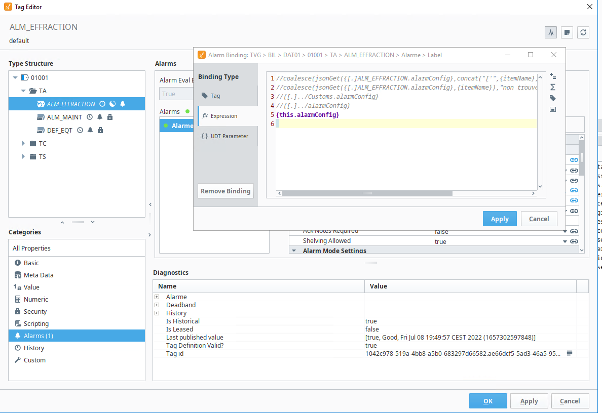

How to refence a custom udt property in an alarme expression binding
**alamConfig is a custom propertie of the UDT**
The label propertie of an alarm has an expression binding which need to read this custom prop
Don’t work:
```auto
{[.]../alarmConfig}
{[.]../Customs.alarmConfig}
Seem to be impossible 😭 ?
As a side note : I can’t use an UDT parameter instead of an UDT custom property because I need a **Document** property type.
 ![image](https://us1.discourse-cdn.com/inductiveautomation/original/3X/1/5/158e6f9e684c5546779b672b41c4037dce645dd6.png)

@ggross any idea how to access UDT custom property in expression for that use case ?
IMO, we definitely need somethink like the **parameters** synthax.
```auto
{[.]}../Parameters.xxxx
```auto
{[.]}../Customs.xxxx
**Author:** ![ggross](https://sea1.discourse-cdn.com/inductiveautomation/user_avatar/forum.inductiveautomation.com/ggross/32/12668_2.png) [@ggross](https://forum.inductiveautomation.com/u/ggross)\
**Post date:** [July 13, 2022, 3:21pm UTC](https://forum.inductiveautomation.com/t/how-to-refence-a-custom-udt-property-in-an-alarm-property-expression-binding/61691/3 "2022-07-13T15:21:10Z")
@mazeyrat, to be able to do this you would need to do something like:
`tag(concat('[.]../',{RootInstanceName},'.<Prop Name>'))`
We added the Pre-Defined Parameters `RootInstanceName` and `ParentInstanceName` in 8.1.13 for these types of relationships, so hopefully one of those can be used to get what you need.
The `Customs` and `Parameters` syntax is something I will discuss with the team. I can see how it could be useful.
Garth

Thanks a lot !
I missed the {RootInstanceName} and the support for “[.]…” in tag()
I thinks that {[.]}…/Parameters.xxxx is already available ?

Glad that worked.
Yes, the `{[.]}…/Parameters.xxxx` syntax is already there, my wording was just a bit off. It is considered by the system to be a folder which is why it works how it does. The custom props one might be a bit cumbersome to add because they aren’t separated out of the definition like parameters. We will discuss other options as well just to try and make it easier to find a solution to this type of situation as there is a clear problem that we should try and make better.
