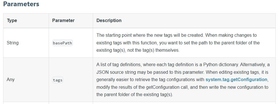

If I have a custom property in a tag, how could I remove it?
My current work around is this:
```python
# pseudo code
tag = system.tag.getConfiguration("tag/path")
tag.pop("custom", None)
system.tag.configure("tag/path", tag, "o")
Is there a more direct way?
Thanks!
**Author:** ![dkhayes117](https://sea1.discourse-cdn.com/inductiveautomation/user_avatar/forum.inductiveautomation.com/dkhayes117/32/68344_2.png) [@dkhayes117](https://forum.inductiveautomation.com/u/dkhayes117)\
**Post date:** [November 6, 2025, 2:02pm UTC](https://forum.inductiveautomation.com/t/how-to-remove-a-custom-property-for-a-tag-via-scripting/111990/2 "2025-11-06T14:02:12Z")
This seems to be the idiomatic way to do it. I wouldn’t call it a work around.
EDIT: You should probably check the pop value before you run the configure, no need to call it if the property did not exist.
