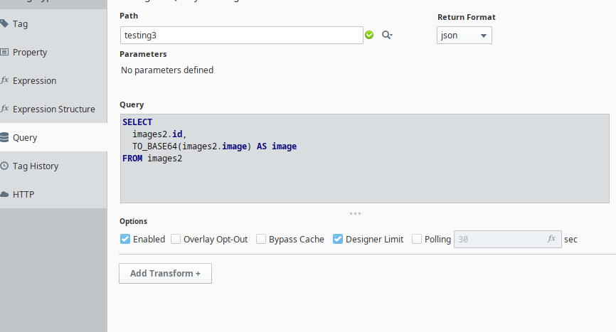

In the query which populates your Flex Repeater, make sure you’re bringing along the `id` column value for each image, and supply this id as a param value.

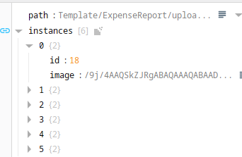

Flex repeater instances with id in it:

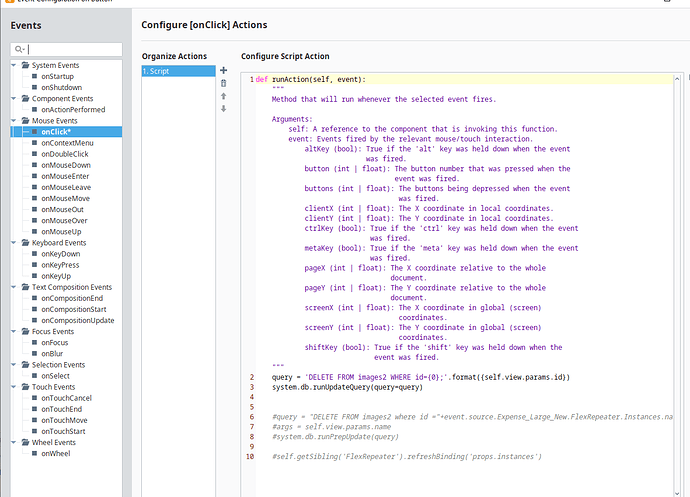

button onClick event:
 ![4](https://us1.discourse-cdn.com/inductiveautomation/original/2X/2/2bc73ca6d5b00cd7308b39050b2e01a907d5c1a9.png)
on clicking row is not deleting from database

It _looks_ like you’re correctly applying the id from your query, but I don’t see the query which populates the Flex Repeater so I can’t verify that…
It’s possible that the query I supplied you isn’t working - I didn’t actually test the query because I don’t have all of the pieces set up as you do. You could _try_ supplying the `image_as_bytes` string since you have it and specify that column of the table instead…

![6](https://us1.discourse-cdn.com/inductiveautomation/original/2X/3/3b256fdc146320b146d60b0e278096ee0e65d852.png)
Flex Repeater’s instances

Remember when I asked if there were any errors in the logs?
This should have generated an error:
```auto
query = 'DELETE FROM photo_table WHERE id={0};'.format({self.view.params.id})
It SHOULD be
```auto
query = 'DELETE FROM photo_table WHERE id={0};'.format(self.view.params.id)
**Author:** ![ptchanchal](https://avatars.discourse-cdn.com/v4/letter/p/f9ae1b/32.png) [@ptchanchal](https://forum.inductiveautomation.com/u/ptchanchal)\
**Post date:** [March 10, 2020, 7:44pm UTC](https://forum.inductiveautomation.com/t/how-to-remove-an-instance-of-flex-repeater-on-button-click/32977/15 "2020-03-10T19:44:36Z")
Wow! thank you so much it worked, Now refreshing flex repeater is only left
