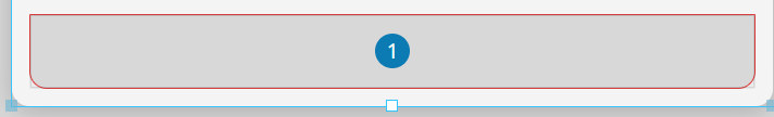

I want to remove the border around the pager on a table component. When trying to give rounded edge you can still see the non rounded border.
![image](https://us1.discourse-cdn.com/inductiveautomation/original/3X/1/3/133c13dee8870339ef7cb968c62efae92507c9da.png)

I can adjust the border radius and background-color with .ia\_pager.
 ![image](https://us1.discourse-cdn.com/inductiveautomation/original/3X/5/e/5e1fab378b567eb2d847431b9d33bd6f8c9f960e.png)

In the table props, you can add a `border-radius` on the table itself as well as the pager:
 ![image](https://us1.discourse-cdn.com/inductiveautomation/original/3X/0/d/0dfc91b4ba7a96418e519ed5730d214f87cfe0ad.png) ![image](https://us1.discourse-cdn.com/inductiveautomation/original/3X/7/6/7637fac55b5710a5db560b5eb1b1db1eb6d5158f.png)
If the values match, it should look like this:
 ![image](https://us1.discourse-cdn.com/inductiveautomation/original/3X/9/3/93f1d68d6d7c4414522f485ecd3a99c3e5684888.png)
The advanced stylesheet shouldn't be necessary.

Thanks @djs . I matched my settings exactly and till get this:
 ![image](https://us1.discourse-cdn.com/inductiveautomation/original/3X/f/0/f09e9b7551caba412a44bd6d0c83813d018dec5b.png)
When I specify a bright border in pager you can clearly tell that the unwanted border I’m talking about is not really part of the ia\_pager class:
 ![image](https://us1.discourse-cdn.com/inductiveautomation/original/3X/1/6/16b711c3c9e0498eb2670664796b9aa9c3b74228.png)
 ![image](https://us1.discourse-cdn.com/inductiveautomation/original/3X/2/4/24a38204afaa0543d5d4cbe534865d0dc50f6f37.png)
But even the css code you provided didn’t work.

For some reason this very specific setup did the trick for me:
```python
.pager-container, .pager {
    border: none !important;
    border-bottom-right-radius: 10px;
    border-bottom-left-radius: 10px;
    box-shadow: none !important;
