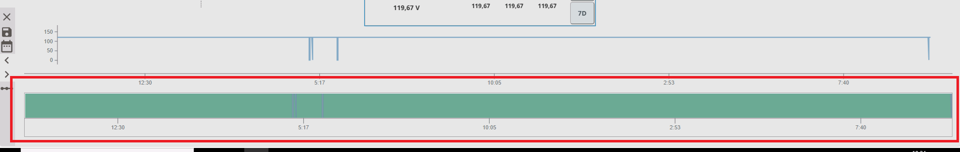

Hi everyone,
I'm using the Power Chart component in Perspective (Ignition version 8.1.49), and I'm trying to remove the additional time axis that appears at the bottom when the chart is in historical mode — a kind of mini time range selector, as shown in the screenshot.
 ![printforum](https://us1.discourse-cdn.com/inductiveautomation/original/3X/3/5/35f6a33955aa985031e7c2c2d2fdf0a5ae0a4a18.png)
I’ve already tried the following settings:
- config.visibility.showRangeBrush: false
- Clearing `config.rangeSelectorPen`
Even after applying these changes, the bottom chart still appears.
Does anyone know how to **completely hide this additional time axis / mini-chart** in Power Chart when in historical mode?
Thanks in advance!
**Author:** ![Steve.Perry](https://avatars.discourse-cdn.com/v4/letter/s/3be4f8/32.png) [@Steve.Perry](https://forum.inductiveautomation.com/u/Steve.Perry)\
**Post date:** [December 16, 2025, 2:16pm UTC](https://forum.inductiveautomation.com/t/how-to-remove-the-additional-time-axis-at-the-bottom-of-power-chart-historical-mode/112155/2 "2025-12-16T14:16:41Z")
A very good question! I hoped to find an option in the “visibility” props…..but no.
I have the same need.
**Post date:** [December 16, 2025, 6:38pm UTC](https://forum.inductiveautomation.com/t/how-to-remove-the-additional-time-axis-at-the-bottom-of-power-chart-historical-mode/112155/3 "2025-12-16T18:38:10Z")
@lizandra.santos This can be removed using CSS.
> [@\[FEATURE-1705\] Disabling parts of the Perspective Power Chart](https://forum.inductiveautomation.com/t/feature-1705-disabling-parts-of-the-perspective-power-chart/57596/5):
> Here is the CSS for removing the range selector: .ia\_powerChartComponent\_\_chart .range-selector-container{ display: none !important; } I do agree with this.
