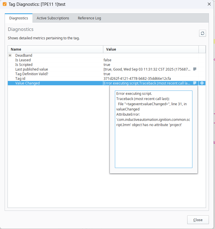

**Author:** ![Chris\_Bingham](https://avatars.discourse-cdn.com/v4/letter/c/e5b9ba/32.png) [@Chris\_Bingham](https://forum.inductiveautomation.com/u/Chris_Bingham)\
**Post date:** [September 3, 2025, 3:05am UTC](https://forum.inductiveautomation.com/t/how-to-send-a-message-to-teams-chat-on-a-tag-value-change/110323/6 "2025-09-03T03:05:33Z")
> [@andy.liu](#):
> `system.util.project.teams_integration.send_teams_message(payload)`
This line seems suspect. What project is configured as your [Gateway Scripting Project](https://www.docs.inductiveautomation.com/docs/8.1/platform/scripting/scripting-in-ignition/project-library#gateway-scripting-project)?
To aide in troubleshooting, right-click on a tag which has this script configured, click on [View Tag Diagnostics](https://www.docs.inductiveautomation.com/docs/8.1/platform/tags/tag-diagnostics#accessing-the-tag-diagnostics-window), I'm guessing you will will see an error next to **Value Changed**.
**Author:** ![andy.liu](https://avatars.discourse-cdn.com/v4/letter/a/c67d28/32.png) [@andy.liu](https://forum.inductiveautomation.com/u/andy.liu)\
**Post date:** [September 3, 2025, 3:36am UTC](https://forum.inductiveautomation.com/t/how-to-send-a-message-to-teams-chat-on-a-tag-value-change/110323/8 "2025-09-03T03:36:45Z")
Yes, there were some errors. Should I change "project" to the project name?
[![image](https://us1.discourse-cdn.com/inductiveautomation/original/3X/b/e/be3a925a6dcf015eca3a83fa035ea8efb17e0d54.png)](https://us1.discourse-cdn.com/inductiveautomation/original/3X/b/e/be3a925a6dcf015eca3a83fa035ea8efb17e0d54.png "image")
[image743×792 38.9 KB](https://us1.discourse-cdn.com/inductiveautomation/original/3X/b/e/be3a925a6dcf015eca3a83fa035ea8efb17e0d54.png "image")
[![image](https://us1.discourse-cdn.com/inductiveautomation/original/3X/7/6/769837062c74089464780e9d0acec82c6d0c2f5d.png)](https://us1.discourse-cdn.com/inductiveautomation/original/3X/7/6/769837062c74089464780e9d0acec82c6d0c2f5d.png "image")
[image1487×115 4.41 KB](https://us1.discourse-cdn.com/inductiveautomation/original/3X/7/6/769837062c74089464780e9d0acec82c6d0c2f5d.png "image")
