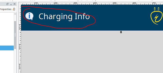

Hi!
I would like to show or hide an object in a docked window accroding to the main window being
currently showed. Ex, I would like to show the label "Charging Info" in the docked view, only if the charging main window is currently displayed:
 ![image](https://us1.discourse-cdn.com/inductiveautomation/original/3X/5/5/55f1b9cf7194dc48da85157eb5d08b370a9c693b.png)
How can I achieve that?
Thank you!

This looks like Vision, not Perspective.
@Emile_Laplante,
This seems like bad design. A main window should be in charge of its own presentation. Why have the docked window at all if it's only relevant based on one particular window being open?
That said, there's a [`[System]Client/User/CurrentWindow`](https://docs.inductiveautomation.com/display/DOC81/System+Tags#SystemTags-SystemClientTags(VisionOnly)) you can bind to that might give you the information you want?

Hi Paul,
[`[System]Client/User/CurrentWindow`](https://docs.inductiveautomation.com/display/DOC81/System+Tags#SystemTags-SystemClientTags(VisionOnly)) was the solution I was looking for.
Thanks.
