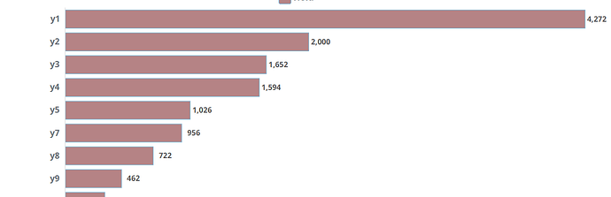

Hi team, i have made the chart as suggested, it is working for me. But only alternate row of label is shown in Y axis. How to fix this.

**Author:** ![jayachandran.m](https://avatars.discourse-cdn.com/v4/letter/j/f4b2a3/32.png) [@jayachandran.m](https://forum.inductiveautomation.com/u/jayachandran.m)\
**Post date:** [October 30, 2025, 11:34am UTC](https://forum.inductiveautomation.com/t/how-to-switch-a-vertical-bar-chart-to-horizontal-bar-chart-in-xy-chart-component-in-perspective/58103/15 "2025-10-30T11:34:35Z")
Hi team, found the solution. I have adjusted the Y-axis→ appearance→grid→minDistance adjusted to 5. Now the all the y axis label are displayed.
