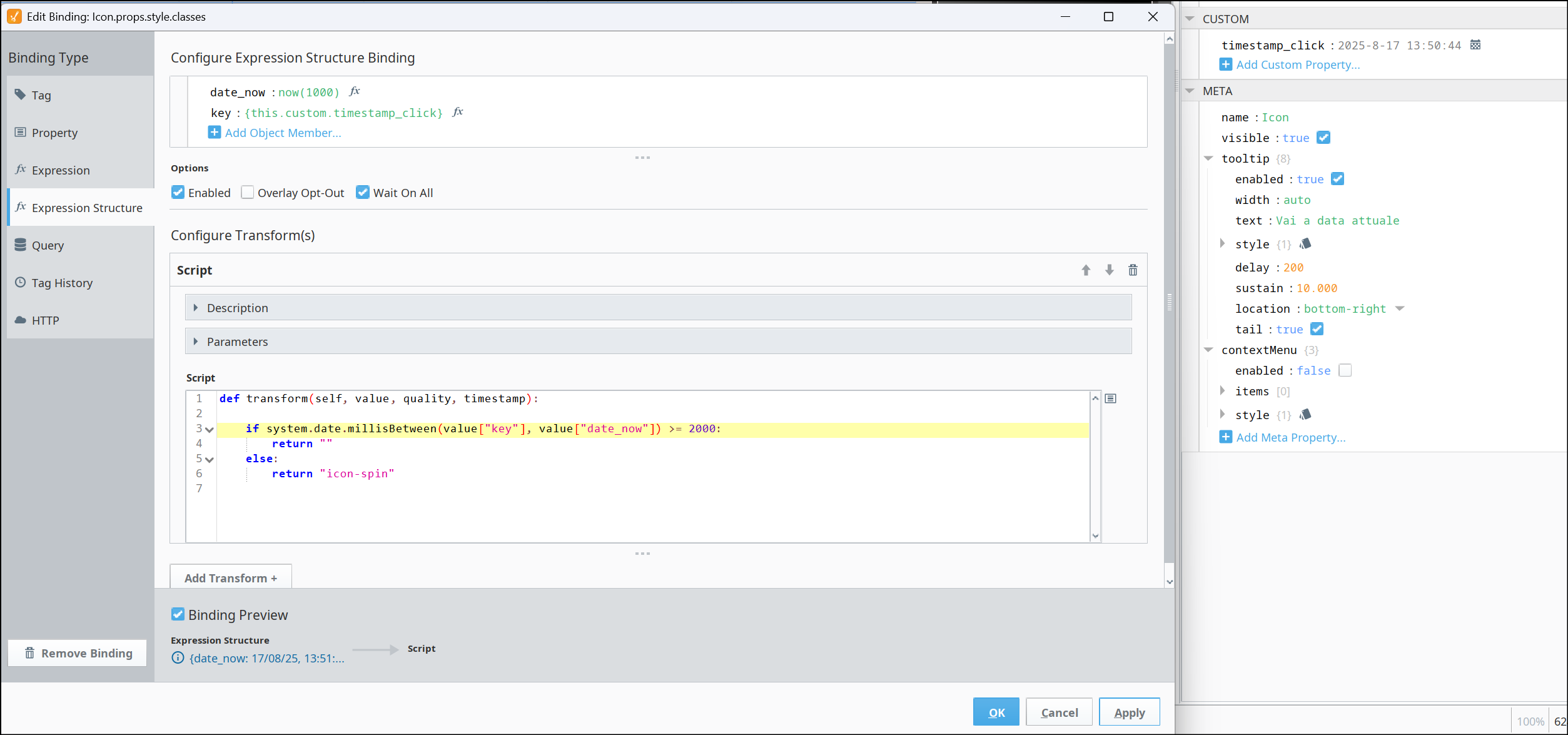

**Author:** ![Aiasa21](https://avatars.discourse-cdn.com/v4/letter/a/aeb1de/32.png) [@Aiasa21](https://forum.inductiveautomation.com/u/Aiasa21)\
**Post date:** [August 17, 2025, 11:55am UTC](https://forum.inductiveautomation.com/t/how-to-trigger-a-stylesheet-animation-on-click/109855/4 "2025-08-17T11:55:36Z")
I’m testing this to make it “works” but actually I don’t like it very much.
When I click the icon I save the timestamp click in a custom property of the icon and the I bind the classes property of the icon with this expression structure.
I know that the animation takes 2 second to works and so after 2000ms I clear the class property.
Do you have other suggestion to how improve this kind of job?
 ![image](https://us1.discourse-cdn.com/inductiveautomation/original/3X/9/1/91496bbbddfe861640d3f10a20339566d66cb8b4.png)
**Author:** ![David\_Stone](https://sea1.discourse-cdn.com/inductiveautomation/user_avatar/forum.inductiveautomation.com/david_stone/32/79749_2.png) [@David\_Stone](https://forum.inductiveautomation.com/u/David_Stone)\
**Post date:** [August 17, 2025, 11:56am UTC](https://forum.inductiveautomation.com/t/how-to-trigger-a-stylesheet-animation-on-click/109855/5 "2025-08-17T11:56:11Z")
```python
import threading
def delayed_function():
    self.props.style.classes = ""
self.props.style.classes = "icon-spin"
# Set the timer
timer = threading.Timer(5.0, delayed_function)
timer.start()
Essentially you make a thread that will be executed in the future that removes the class, and you set the animation to run, then the thread will later remove the class when the thread runs.
The thread is async, so there are a few different ways to deal with the way it runs, but essentially its pretty safe and doesn pause any code.
**Post date:** [August 17, 2025, 12:06pm UTC](https://forum.inductiveautomation.com/t/how-to-trigger-a-stylesheet-animation-on-click/109855/6 "2025-08-17T12:06:25Z")
It works very good. I add the check before running the script to optimise it:
```python
`if self.props.style.classes == "":
    import threading
    # Set the timer
    timer = threading.Timer(2.0, delayed_function)
    timer.start()`
I think about how to implement it in a general function so to reuse it.
Thanks for your time, I appreciate it.
