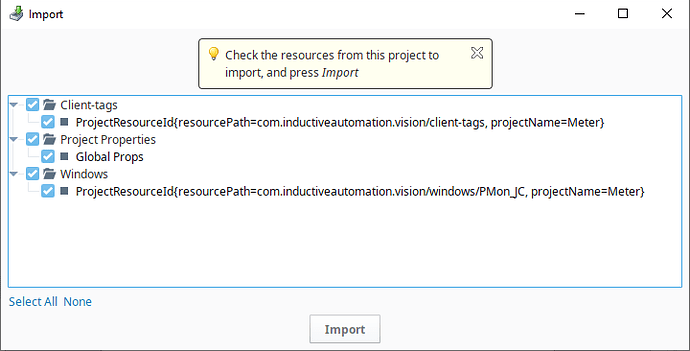

**Author:** ![Jason.jones](https://sea1.discourse-cdn.com/inductiveautomation/user_avatar/forum.inductiveautomation.com/jason.jones/32/18671_2.png) [@Jason.jones](https://forum.inductiveautomation.com/u/Jason.jones)\
**Post date:** [October 27, 2020, 10:35pm UTC](https://forum.inductiveautomation.com/t/how-to-use-a-button-to-change-the-tag-that-is-being-bound-to-an-led-display-or-any-component/39483/9 "2020-10-27T22:35:24Z")
I tried a blank project … but shouldn’t the view you created show up in the import window where it allows you to select what items to import? The first screen grab is what is available in the PowerMon zip … the second screen grab is from the help for the import process.
**Author:** ![witman](https://avatars.discourse-cdn.com/v4/letter/w/d2c977/32.png) [@witman](https://forum.inductiveautomation.com/u/witman)\
**Post date:** [October 28, 2020, 4:07am UTC](https://forum.inductiveautomation.com/t/how-to-use-a-button-to-change-the-tag-that-is-being-bound-to-an-led-display-or-any-component/39483/10 "2020-10-28T04:07:36Z")
I think @JordanCClark’s export includes a Vision window rather than a Perspective view.
 ![image](https://us1.discourse-cdn.com/inductiveautomation/original/3X/a/b/abee211e3582b92b888b823cb90878b5d655f396.png)
After import, look for it here:
 ![image](https://us1.discourse-cdn.com/inductiveautomation/original/3X/8/d/8d975357a3246e783dc04419439f867fd0338743.png)
