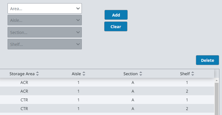

**Author:** ![mdemaris](https://sea1.discourse-cdn.com/inductiveautomation/user_avatar/forum.inductiveautomation.com/mdemaris/32/54639_2.png) [@mdemaris](https://forum.inductiveautomation.com/u/mdemaris)\
**Post date:** [July 7, 2023, 10:06pm UTC](https://forum.inductiveautomation.com/t/how-to-use-a-drop-down-list-to-filter-data-in-a-table/75305/12 "2023-07-07T22:06:46Z")
@Cristian_Gomez I hope you don't mind me jumping on your train, but rather than posting a new thread on the same topic, and I hope this helps you and others and helps me to solve my current issue.
Imagine four drop downs and one table. This feature allows for creating and deleting multi-part locations for our system.
 ![image](https://us1.discourse-cdn.com/inductiveautomation/original/3X/d/a/da264be0ad814f62fdabc1ddfa4cb2be72ea3285.png)
Each drop downs' options are bound to a query. The table has a custom prop, `table_data` to which the `table.props.data` is bound. (I'll call this **Query1** )
The first three drop downs will enable the drop down below it, get the selected value of the previous drop downs, and send those parameters to a named query, (I'll call this **Query2** ) then set the `table.custom.table_data` to the result set of the named query. This is done via scripting on the `onSelect` event of each drop down. The results in the table are filtered down each time the event fires, so that when I want to add a new location I can see if that location already exists. This setup works, as I mentioned in an above post, I just don't like the way the events (@paul-griffith) 🙂 work, as I am used to a slightly better event setup in MS Access (at least for this type of component).
Example of the first drop down script:

My frustration is that this same setup, with four drop downs and one table, is not working in another view.
 ![image](https://us1.discourse-cdn.com/inductiveautomation/original/3X/a/d/ad8a3e6db39ae960ecfcb2cf2f8ba8cbdb32172e.png)
This is another location system used for something else. Each drop down is set up the same way, as is the table.
Here is the script from the first drop down:
```auto
def runAction(self, event):
	namedQuery = "AST/v_Asset_Locs_Cbo_Filtered"
	bldg = self.props.value
	params = {"p_Bldg":bldg}
	self.parent.parent.getChild("coord_Right").getChild("Table").custom.table_data = system.db.runNamedQuery(namedQuery, params)
	self.getSibling("cbo_Asset_Area").props.enabled = True
I have set print statements in the `onSelect` events of each drop down, and the variables are getting the correct values. When I test the named query directly, the correct result set is returned. For some reason the result set is not returning to the table. BTW - both `table.custom.table_data` are set to `Return Format: Auto`. This works for the first example just fine, and changing it to `dataset` has no affect, which I expected.
So, in the second example, to test further, I went to both of the named queries and in the `SELECT` statement, named each column in the same order as the table column names. This had no affect, which I expected. I also, just for grins and giggles, added a text area bound to the return set and, as expected, when the table has an empty set, so does the text area.
To clarify the operation here, after selecting the value from the first drop down, the table is empty.
Anyway, when I click the second drop down, the table has a data set and lastly, when I select an item from the third drop down, the data set is empty again. _( I just realized that the first and third drop downs are set to `onActionPerformed`, but I forgot to change the second one. After setting them all to `onActionPerformed` I get no data sets returned until I hit the "Clear" button.)_
That's all I have for now.

**Post date:** [July 7, 2023, 10:13pm UTC](https://forum.inductiveautomation.com/t/how-to-use-a-drop-down-list-to-filter-data-in-a-table/75305/13 "2023-07-07T22:13:39Z")
Your problem is very similar to this:
> [@Controling bindings evaluation order](https://forum.inductiveautomation.com/t/controling-bindings-evaluation-order/75842/23):
> Try this:
> > **View JSON**
> > { "custom": { "isFresh": true }, "params": { "category\_id": "", "family\_id": "", "item\_id": "" }, "propConfig": { "custom.isFresh": { "access": "PRIVATE", "binding": { "config": { "expression": "coalesce({view.params.family\_id}, {view.params.category\_id},…
Just differs on what to do with the dropdown values at the end. Note how little scripting is actually needed. Certainly not needed to run the named query (and probably shouldn't be, to keep the flow of data smoothly asynchronous).
