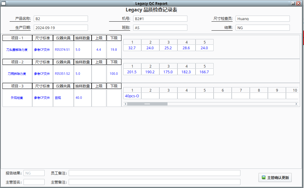

I want to use a template repeater within a template, which means a nested template. I set the Repeat Behavior as "Dataset", and binding the Template Parameters to a Dataset. I'm not clear on how to construct a Dataset to make this nested templates work well.
Does anyone have any idea or any example to share ?

![image](https://us1.discourse-cdn.com/inductiveautomation/original/3X/4/9/49ce4a4fbd54793638a6f3988eba5cd459e970f5.jpeg)
 ![image](https://us1.discourse-cdn.com/inductiveautomation/original/3X/2/4/24ac2e4f85f1087ba701c340ac6af7bdced761d5.png)
I construct a dynamic dataset called ‘detail’， just as above example， it is a dataset[3R\*3C], two columns are with dataset in it. the column 'Detail' is used in first template, and the 'InnerDetail' is used in nested template. Finally, it works well.
**Author:** ![Lion\_Sun](https://avatars.discourse-cdn.com/v4/letter/l/3ab097/32.png) [@Lion\_Sun](https://forum.inductiveautomation.com/u/Lion_Sun)\
**Post date:** [September 26, 2024, 3:54pm UTC](https://forum.inductiveautomation.com/t/how-to-use-a-template-repeater-in-a-template/96475/9 "2024-09-26T15:54:01Z")
Not dataset in object column, just a dataset which with dataset as cells in it. In template repeater property binding, we can only specify one dataset as template parameter. So I use this method to transfer in more than one datasets.

This works in the designer, but does it work if you close the window and re-open it? That's the serialization piece Phil (and I) am worried about. The underlying encoding scheme Vision uses is definitely not _designed_ to support putting datasets inside datasets, so if it does work it's only by "accident" and therefore you're in the realm of "undefined behavior".
**Post date:** [September 26, 2024, 4:28pm UTC](https://forum.inductiveautomation.com/t/how-to-use-a-template-repeater-in-a-template/96475/11 "2024-09-26T16:28:50Z")
Yes, it also works well when I close in designer and open in vision client. I still not quite understand how to provide information in outer dataset to supply the inner nested template. I will further experiment on it. I think if there is an example demo will be better for understanding.
