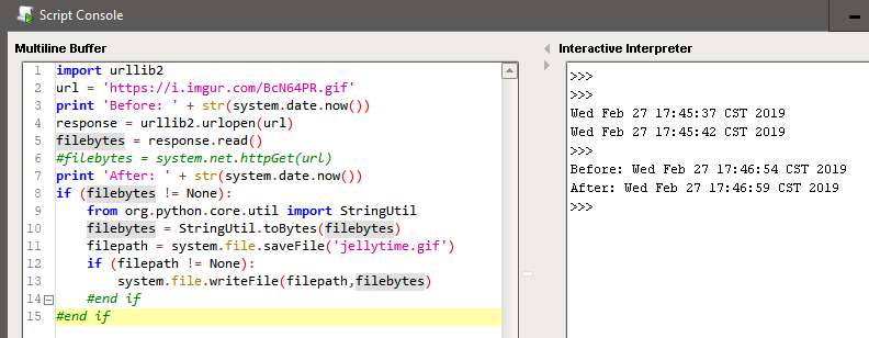

Strange. If I keep running the script multiple times, I will eventually get sub 1-second. But if I pause and try running again, I get a five second delay with urllib2. This is with any file from any site. httpGet consistently returns quickly.
 ![delay](https://us1.discourse-cdn.com/inductiveautomation/original/2X/e/e419a6e2a1752e8a114cc6d593471ead11042f0b.png)

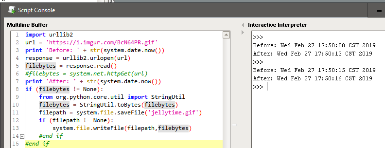

I tried executing again quickly after cancelling the save dialog and it returns with less than 1 second delay
 ![nodelay](https://us1.discourse-cdn.com/inductiveautomation/original/2X/e/ea409aa5b6ae2f2f806d017f5802134ca2bc3cc7.png)
