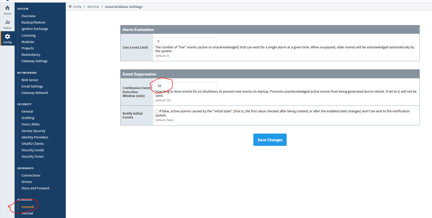

Hi!
I have a long time issue with alarm records to database after each Ignition Gateway start/restart
Actually, when I start Ignition, so from every alarm tag I have record to database even if alarm is not active now.
Maybe there is a property, which I should enable/disable?
I have more than 200 stations with more than 30 defined alarms. So You can imagine how many records I get in database when Ignition Gateway starts...
I delete them manually every time.
Please somebody help me to not letting Ignition to insert these unuseful records to alarm\_events database table)
SOOOO MANY THANX in Advance 🙃
And sorry if there is allready the same topic... but I did not find any...
**Author:** ![MMaynard](https://sea1.discourse-cdn.com/inductiveautomation/user_avatar/forum.inductiveautomation.com/mmaynard/32/3366_2.png) [@MMaynard](https://forum.inductiveautomation.com/u/MMaynard)\
**Post date:** [July 10, 2025, 12:50pm UTC](https://forum.inductiveautomation.com/t/huge-number-of-alarm-records-in-database-after-starting-ignition-gateway/108307/2 "2025-07-10T12:50:58Z")
Did someone change the detection window size?
It defaults to 10 minutes.
 ![image](https://us1.discourse-cdn.com/inductiveautomation/original/3X/3/b/3b43d3b10267ec2c78010acb074ef53013608903.png)
> **[Alarm Event Properties Reference | Ignition User Manual](https://docs.inductiveautomation.com/docs/8.1/platform/alarming/configuring-alarms/alarm-event-properties-reference#event-suppression)**

**Author:** ![iscrac](https://sea1.discourse-cdn.com/inductiveautomation/user_avatar/forum.inductiveautomation.com/iscrac/32/49757_2.png) [@iscrac](https://forum.inductiveautomation.com/u/iscrac)\
**Post date:** [August 8, 2025, 9:27am UTC](https://forum.inductiveautomation.com/t/huge-number-of-alarm-records-in-database-after-starting-ignition-gateway/108307/4 "2025-08-08T09:27:02Z")
Actually today was the possibility to test this.
and it didn’t help. I get a lot of alarms as it was before…
Maybe there is something else I could change in Gateway?
