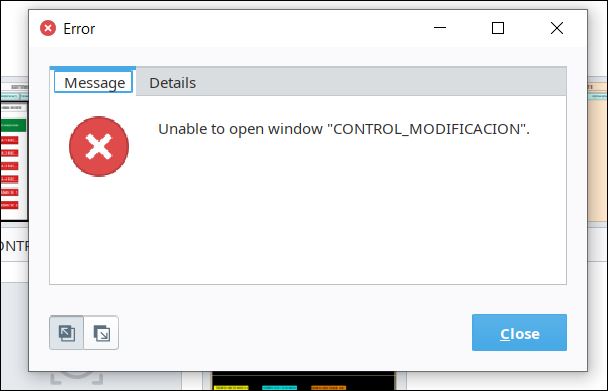

Colleagues, I was working on a project in Vision Designer. I wanted to continue editing it, but out of 5 windows, I could only open 3. The other 2 wouldn't open and gave me a text box error. I've attached images.
What happened? How can I fix it?

What do you see in the 'details' in that error box?

The window has been corrupted somehow. Something may have altered the resource on the disk, like an external agent or antivirus or something. Unfortunately, when a window has been corrupted... it's gone.
The only way to restore it is to restore the window from a project backup or a gateway backup.

Try selecting the view from the tree, that short-cut link may be lost somehow
