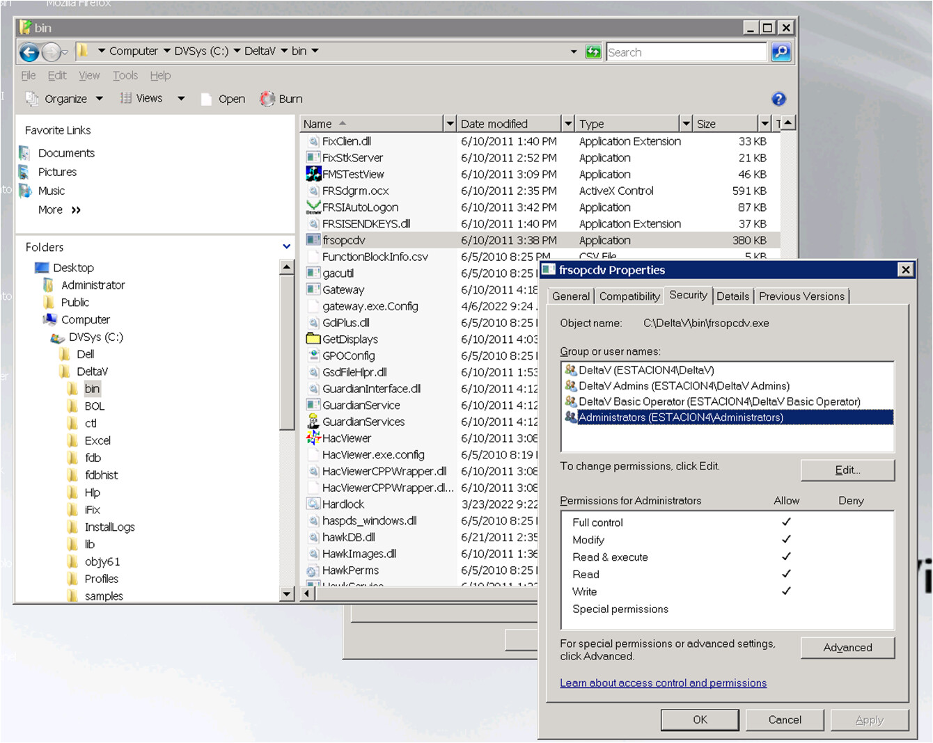

Hi, i just looking for some body help me, yesterday i Move my licence between servers and lost the OPC DA DeltaV (OPC.DELTAV.1 of a DeltaV version 11) the status is Connecting and never Connected, the connection is local with the opc server is in the same server where i have intalled the Ignition Gateway 7.9.9.
 ![Figura1](https://us1.discourse-cdn.com/inductiveautomation/original/3X/0/8/08b12555eacb4d64644159e70ee9eb175d8438de.png)
i try to compare all the permisions for the FrsOpcDv Dcom (i think is the OPC.DELTAV.1) component of the old server and the new server and aparently all is the same
 ![Figura2](https://us1.discourse-cdn.com/inductiveautomation/original/3X/2/a/2a9438a10ededc289014baab6e0bc293bc9fbcb4.jpeg)
The same for the file security properties
 ![Figura3](https://us1.discourse-cdn.com/inductiveautomation/original/3X/c/0/c00df769456fa5d8e9f7997a4b8291dc870da09a.jpeg)

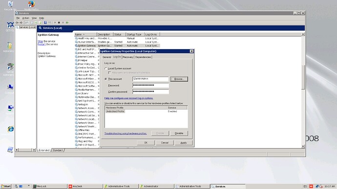

Better, but it is end of support, end of security updates in less than a year. What is your ignition service running as on the original server, any chance its not the local system account?

> [@GeraGarcia](#):
Its working rigth now the problem was the security properties in the services igniton gateway
 ![Figura7](https://us1.discourse-cdn.com/inductiveautomation/original/3X/7/d/7dc1c319a127110ddc7d6f26b31e76d2c1357bad.jpeg)
 ![Figura8](https://us1.discourse-cdn.com/inductiveautomation/original/3X/f/7/f703c61afd8372fff4655b62332b327e2e4f7832.jpeg)
Thanks everybody
